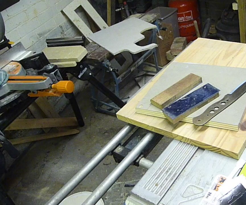

Bandsaw or Jigsaw if using Jigsaw I suggest shaping parts before glue up.
