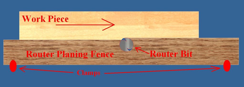

Below is a way of using a router for jointing so the router bit cannot vibrate or jump into the work and make a cupped indentation in the work's edge. The fence (yellow) clamps to the work (brown). The router bolts onto the attachment (yellow). The attachment rides on the fence.

A method I used was to make a fence for my router (used in a router table) that had a hole sized for a bit, where the very tip of the router blade was tangent to the router planing fence edge. Then I used a table saw and cut down one side of the fence (based on the rotation of the router bit) so that it was slightly shallower than the other edge.
As you run your board against the planer board the router bit takes off however much material you took off of the one side. Make sure not to take too much off so that your router can handle the removal, which means you may have to make several passes.
Hopefully the attached image helps.
Reply 13 years ago on Introduction
I apologize for responding so late to your router and fence arrangement for putting a straight edge on a piece of work. You are essentially replicating a planer/joiner bed. I tried this early in my serious woodworking days when I had a molding head cutter for my radial arm saw, but no router. With that setup I found it was just a little too tricky to align the back half of the fence with the cutter. What is so nice about running the work between a long fence and a sanding drum (or router bit) is that the straight edge of the fence is automatically reproduced on the edge to be straightened. There is much less that can go wrong.
