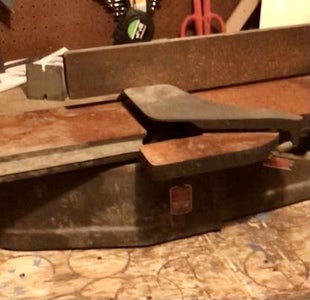

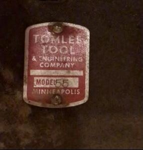

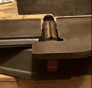

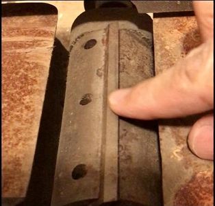

When I acquired this jointer, it was stored in a barn and the dude sold it to me without a motor for less than $10. So I used WD-40 and a scouring pad to remove superficial rust. That’s when I noticed that the blades were in bad shape and needed to be re-sharpened. I remove them and gibs with an Allen wrench and marked each blade and their associated space 1, 2, and 3.

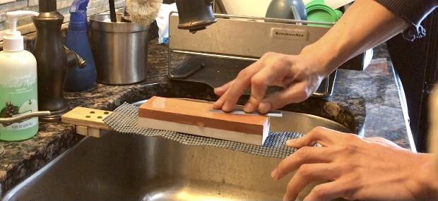

If you really wanted to go the extra mile you could finish them up with a whetstone as I do in my last photo.

Once all of the knives were sharpened to my liking, I put them back with their associated gibs into their slot. This is a long and tedious task, but I do mention it in my video in the beginning.

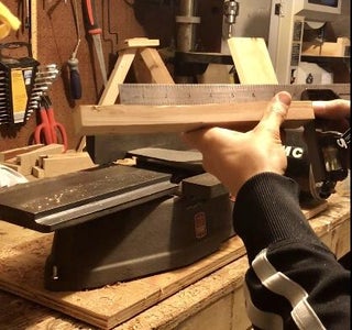

With that, I added a motor and belt to take it for a test spin and it cuts like butter! Now I have a new piece of equipment to add to my workshop!
