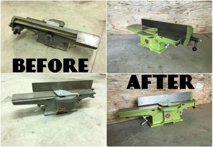

this instructable is a tutorial on the disassembly and restoration of vintage machinery, in this case, a late 40s era delta Rockwell jointer. I started this project when I was gifted this machine by an older woodworker who can no longer work in the shop. this unit is a 4-inch delta/Rockwell jointer with no motor. the plan is to clean the bed and fence, free the spindle, paint the machine, then set the fence and blade height. so let's start pulling it apart.

now comes the point of reassembly once all paint is dry the jointer can be put back together and all of the stops and gauges can be set. once the spring-loaded blade guard and fence are added you can set each of the stops for 45, 90, and 135 degrees. this was done with a machinist square and a combination square. each stop has a small screw for adjusting the stop for achieving a perfect angle.
Step 5: Finished
at this point, the jointer is done the bed is cleaned the body refinished all that is needed is a motor. for this exact model a 1/3hp 1750rpm motor is needed.
