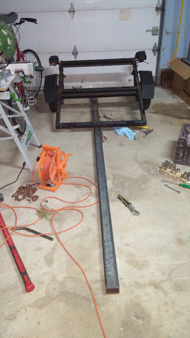

The first order of business is extend the tongue. It's currently around 4ft 2inches long. It attaches to the front and middle cross member.
I'll be replacing it with an 11 ft 3x2" 3/16 wall steel tubing and attaching it to all 3 cross members front to back. In hindsight, 3/16th is a little overkill. If I was to do it again, I'd probably use 2x2 1/8 wall steel tube.
My boat is 10 ft long and I plan to have the boat hang off the back of the trailer 1 foot. So my 11 ft overall length trailer should be fine.
There were 4 bolts holding the old tongue onto the frame. I removed those pretty easily and mocked up the new tongue.

Next up is to center the new tongue on the frame, clamp it and drill the new holes.
Make sure you measure twice that it's centered and also check with a square that it's .. well square. you don't want it crooked or it will tow poorly.
Drill the holes and fasten them with bolts. I used grade 5 3/8 bolts with washers on both sides, a lock washer and loctite.

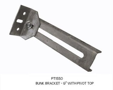

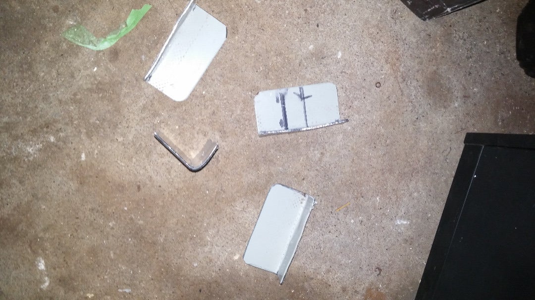

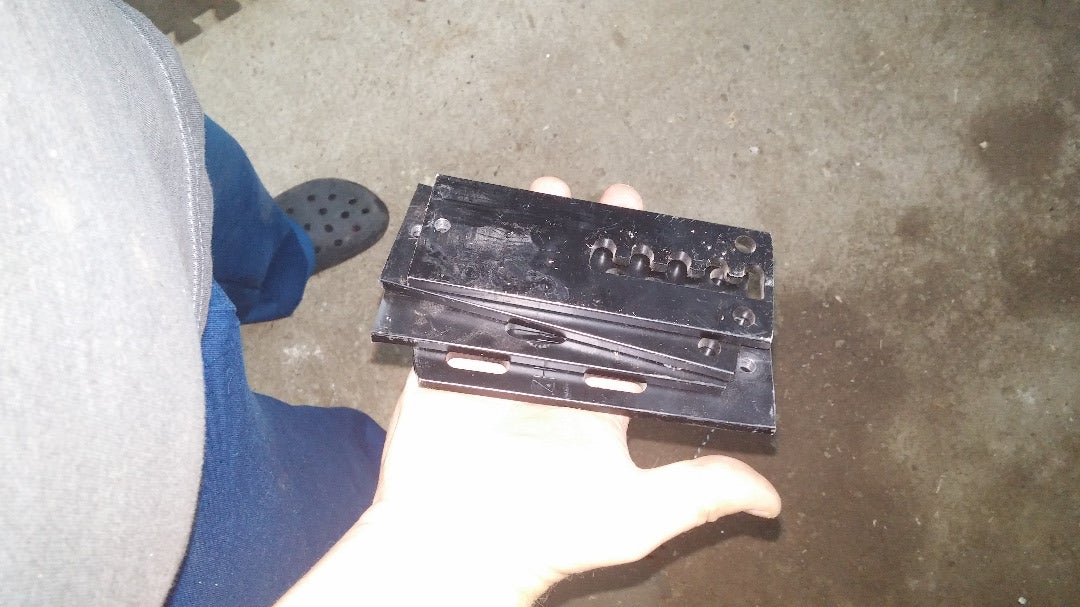

So bunk brackets at the local store cost 19$ each. That's 80$ for 4!! Forget that.. I'll make some out of some scrap metal.
The above metal was taken from my office chair arms and some old shelve brackets.
The bonus with the store bought brackets are they are height adjustable, mine I'm making to be a static 6 inches.They will be able to pivot, but the height won't be adjustable.

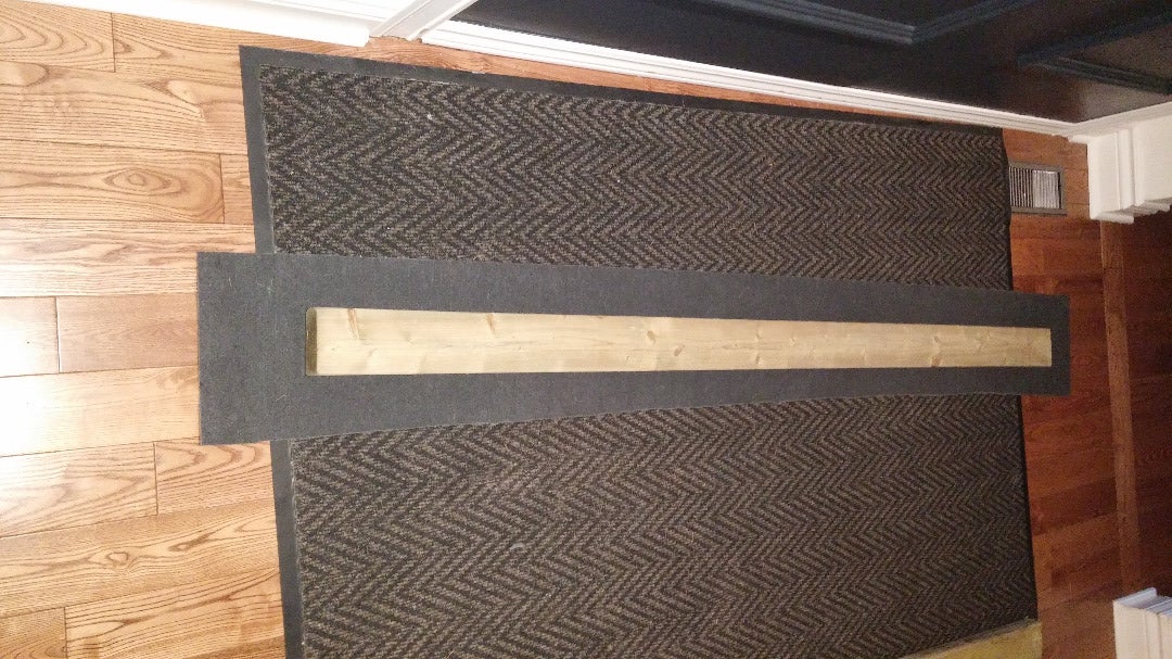

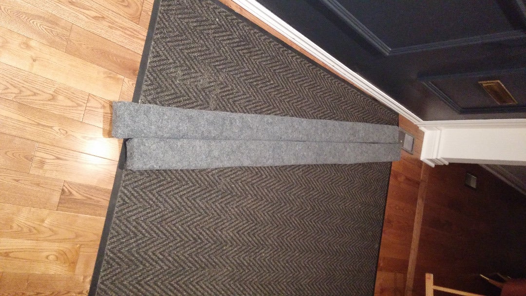

The bunks themselves are made from 2 2x4x8's, pressure treated.
I wrapped them in outdoor carpet which was about 15$ (24 feet)
