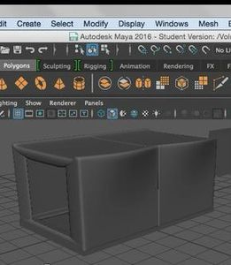

Step 1: Constructing the 3D Model
The 3D Model we constructed was created in the "Autodesk Maya 2016" program. Essentially, we created a normal box with notches to facilitate future additions to the outside. The front of the box has space to display the 8x8 LED matrix clearly, while the rest of the box is hollow in order to allow our parts to fit inside. The box itself measures out to be 8" long x 4.5" wide x 3.5" high. Feel free to use these measurements as an example, or you can make your model as large or as small as you wish. Naturally, the display space at the front will be about the size of the LED matrix you intend to use, so be sure to measure your matrix and use the measurements to create your display box. As you can see in our illustrations, our box has a flat base to position the parts while the top portion of the box is cut in half. The cut allows it to be printed with a bit more ease while making it easier to take apart if you ever needed to replace or adjust any of the inside parts.
