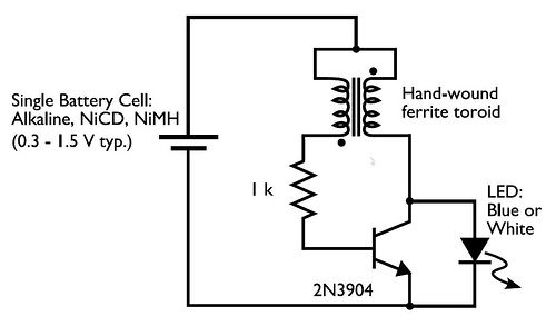

The circuit starts when the transistor is off. Current flows through the left hand side of the transformer and through the 1k resistor, into the base of the transistor. The transistor turns on slightly and produces a current in the collector emitter circuit. This allows current to flow in the right hand winding of the transformer and produce magnetic flux. This flux cuts the turns of the left hand winding and produces a voltage that adds to the voltage produced by the battery.
This increases the current into the base of the transistor and the transistors turns on more. This continues and the transistor turns on more and more until it cannot turn on any harder. At this point the magnetic flux in the right hand winding is a maximum but is not expanding flux and thus the left hand winding does not produce any additional voltage. The current into the base of the transistor reduces and the transistor turns off slightly.
The current through the right hand side of the winding reduces and the magnetic energy in the core of the ferrite ring starts to collapse and produce a voltage (in both windings) of opposite polarity. In the left winding, it starts to turn the transistor off completely and in the right winding, it delivers this energy to the LED. Now here’s the clever part. When the current is abruptly switched off, as is the case with this circuit, a voltage is produced in both windings that has opposite polarity to the original voltage and will be higher amplitude than the original voltage.
This voltage can be 10 or even 100 times higher than the original voltage and this is called the “Q” of the circuit. We are not creating something for nothing as the voltage will be higher but the current will be lower than the current drawn from the battery. The voltage produced by this circuit will be over 10v but a white LED has a characteristic voltage of about 3.2v to 3.6v and all the energy in the 10v spike, and the accompanying current, will be delivered to the LED to produce illumination. The LED starts to absorb energy at 3.2v and that’s why the voltage across it never gets any higher than 3.6v.

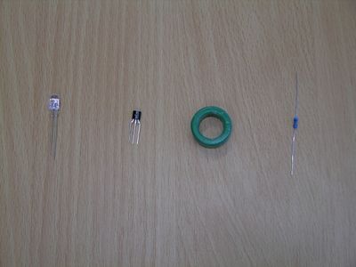

Step 2: Components
1) NPN Transistor
2) 3V Super Bright LED (any colour will be fine)
3) Wiring (x2 meters)
4) Breadboard*
5) Ferrite Core
6) 1K Ohm Resistor

Step 3: Circuit Diagram

If you are you using the breadboard please examine the images above on where to place the components. See the circuit diagram in Step 3 to familiarize yourself with the way the components are connected.#

3. Connect the toroid to the breadboard. The twisted wires go to the positive terminal of the battery
4. Connect the orange coloured wire to the resistor
5. Connect the green wire to the collector terminal of the transistor and the long lead of the LED (Anode)
