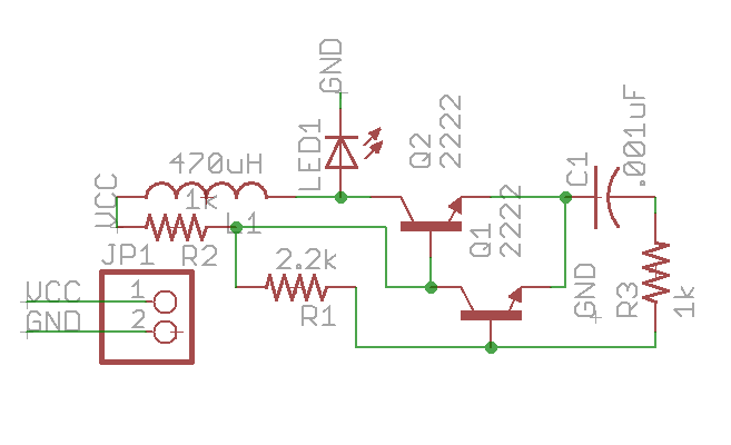

Attached are the Eagle schematic and board files.

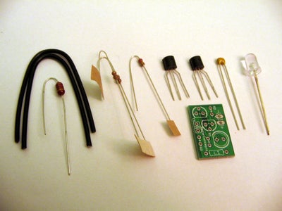

Step 2: Gather Parts
 Make sure you have all of the parts. Here is the listing:
 PCB
 Qty 2. Transistor
2.2k resistor
Qty 2. 1k resistor
Inductor
Capacitor
LED (your choice of color)
Qty 2. wire pieces

    I can't open eagle docs and I can't tell where to connect the input +/- or where the output+/- come from on the schematic provided. please help

    Just a question before building it: What can I do if I want higher output voltage? Which part(s) should I change?

    0.001 uf = 1 nf = 1000 pf
    http://www.justradios.com/uFnFpF.html

    I found a IC based boost regulator at Pololu that I liked. http://www.pololu.com/catalog/product/796 The circuit on this page uses 2N2222 which I haven't seen before. That will cause a loss in efficiency but should be a lot easier to find than the transistors of the classic Joule Thief.

    what inductance value is it?
