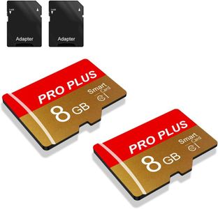

  5. Memory Card & Reader (Provided Image of the one I used)
  6. I used a TF Card or MicroSD Card and its reader.

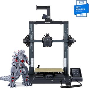

  7. 3D Printer (Provided Image of the one I used)

Step 4: Setup 3D Printer
Once you the file has been sliced and adjusted. Finally you can then save it to your memory card. Insert the memory card into the printer. Before you print ensure your printer is set up by...
  1. Center your Printer Bed and Printer Extruder by zeroing it out
  2. Calibrate the Printer
  3. Insert filament
  4. Pre-heat the filament
  5. Apply a thin layer of your glue stick to the printing bed to ensure that the first layer print sticks well
  6. Begin Printing!!!
