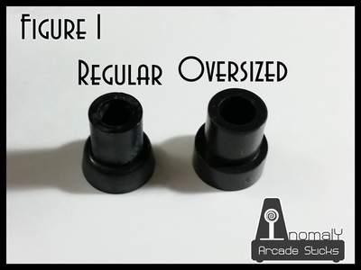

Oversized Actuator - The Plastic actuator at the bottom of the joystick shaft is what presses the switches Up, Down, Left, Right. By installing a bigger actuator you don't have to move the joystick as far to get the input to come out. Which makes for fast inputs overall.

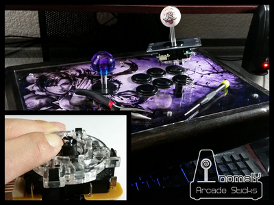

1. Open your Fightstick so that you have access to the bottom of the joystick.
Note: You do not need to remove the joystick but make sure the ball top is resting in your lap or on a surface.

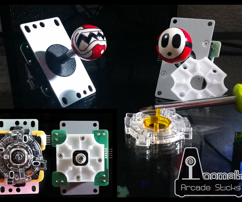

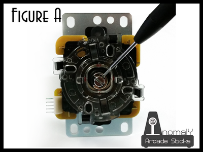

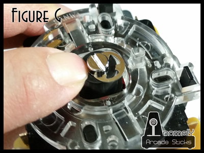

2. Stick the tip of the flat head precision screwdriver into one of the holes in the C clip on the bottom of the joystick shaft. Figure A, then pry the the clip off gently.

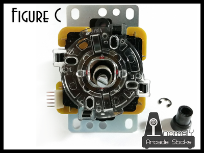

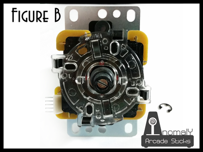

3. Remove the default Actuator. Figure B, The spring should now be visible. Figure C

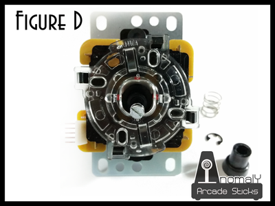

4. Remove the spring, leaving just the shaft sticking out. Figure D

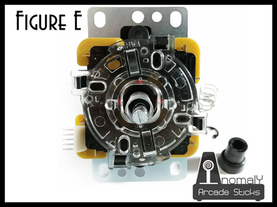

5. Put the new 1lb tension spring on the shaft. Figure E

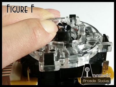

6. Put the new actuator on and press down so that the slit for the C clip is showing. Figure F.
7. Push the C clip into position, you wont be able to get it all the way on but push it hard enough to get stuck there. Figure G.

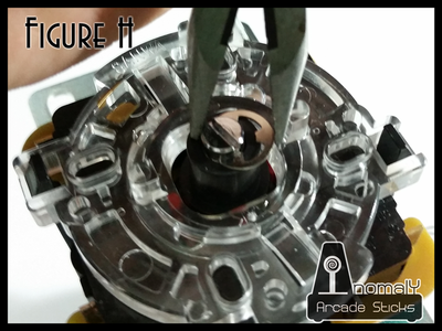

8. Using the pliers have one end on the metal shaft and the other on the clip then squeeze the clip onto the shaft. Figure H.
