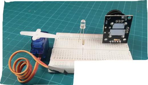

Step 2:
Connect these components to the breadboard.
Joystick module with Arduino.

Use only the PMW pins to connect the servo motor. The 220ohm resistor is used to control the current flowing through the LED bulb. The 10k resistor is used for the pull-up circuit.
