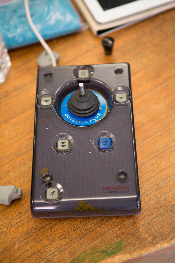

With the use of a 3D printer, we are able to create an inexpensive and highly customisable joystick controller. It can be customised to the user’s grip or control preference allowing for greater control than the average injection moulded knob.
Simply unscrew the plastic knob that is on the user’s joystick and replace with the custom made Joystick Attachment. The joystick can now be more easily controlled with the tip of a single finger slotting into a depression in the plastic, or with multiple fingers gripping the controller.

Assess the shape and mobility of the hand and fingers, taking measurements of diameter of the finger/fingers that are to be used.
Remove knob from joystick, and measure diameter and length of the stick the attachment is to be placed on.
