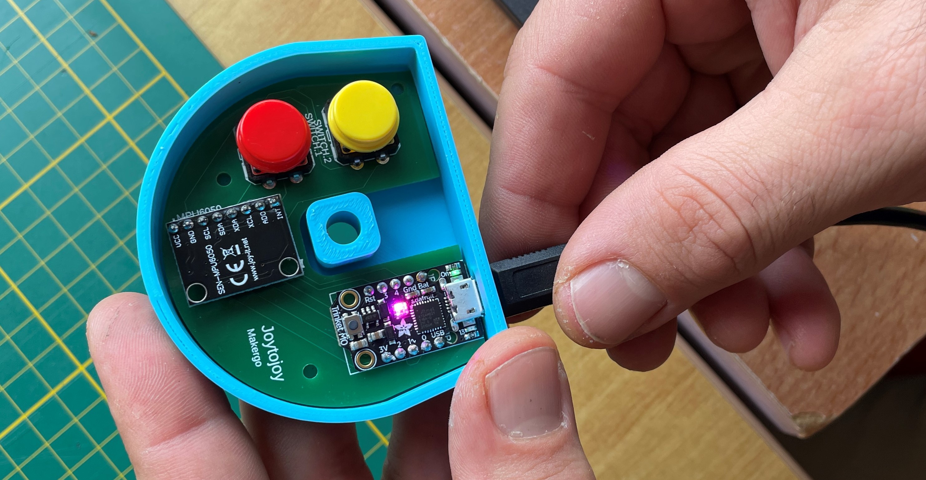

HARDWARE
Enclosure : 3D printed parts
  • Base : Host the electronic stuff, present a hole to fit in place of the standard wheelchair's joystick knob
  • Top : Features the joystick handle and two holes for the buttons.
Electronic components
  • 1 × ADAFRUIT Trinket M0 Adafruit 3500
  • 1 × Sensor MPU6050 Joy-it SEN-MPU6050
  • 1 × Colorful Round Tactile Button Switch Assortment Adafruit 1009
  • 1 × USB cable USB 2.0 A Male to USB 2.0 Micro B Male
  • 1 × Printed circuit board (Here are Gerbers's files, you can order one from an online supplier, you can also make a joytojoy without PCB, only with wire and solder following theses steps)

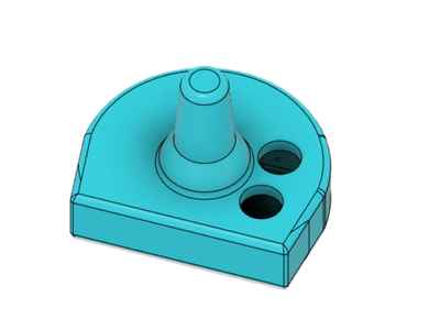

Step 2: Select the Design Fit to Your Needs
The enclosure is made of two printed parts (base and top) wich will clip together.
To select the good design, you' have to choose a base compatible with your wheelchair's joystick (depending of your wheelchair's brand) and an top handle fit to your ergonomic needs and motor possibilities
WHEELCHAIR COMPATIBILITY
For a 6.4 mm diameter joybar = Power wheelchair with Rnet or PRIDE electronic : Permobil, Ottobock, Sunrise, Levo.
select : base A_6.4 mm hole.stl
For a 5mm diameter joybar = Power wheelchair with Linx electronic (Invacare)
select : base B_5mm hole.stl

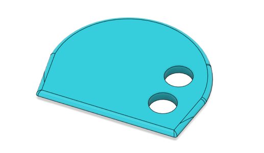

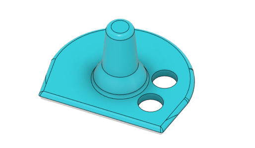

HANDLE
For standard needs (standard joystick handle) : select the file top_joystick.stl
If you need a ball to facilitate gripping select the file : top_ball.stl
You can also design a specific handle adapted to your need (ergonomic, esthetic) with your favorite CAO software (for example FUSION 360 or tinkercad).
With Fusion 360
Open the JOYTOJOY .f3z file, design an handle suit to your needs, download the top_flat.stl file and mix them together.
With Tinkercad
Open the tinkercad joytojoy design corresponding to your wheelchair, then you can easily design an handle by adding different 3d forms and mix it with the standard joystick handle.

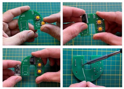

Step 4: Electronic Assembly
Bring together the different components
Individually prepare the components :
  • Solder headers on the trinket m0
  • Cut off the four no use headers of the SEN-MPU6050 ( XDA, XCL, ADO, INT)
  • Bend the four headers (VCC, GND, SCL,SDA) at a 90 degree angle
Insert the components on the PCB, following one board printed indications
  • Switches
  • MPU6050
  • Trinket M0
Soldering
  • Turn the pcb
  • Solder the different components pins
  • Cut of the excess lenght of the pins

  • Place button caps on switches
  • Insert PCB onto the enclosure
  • Place the top part on base part
  • Push it to clip the two parts

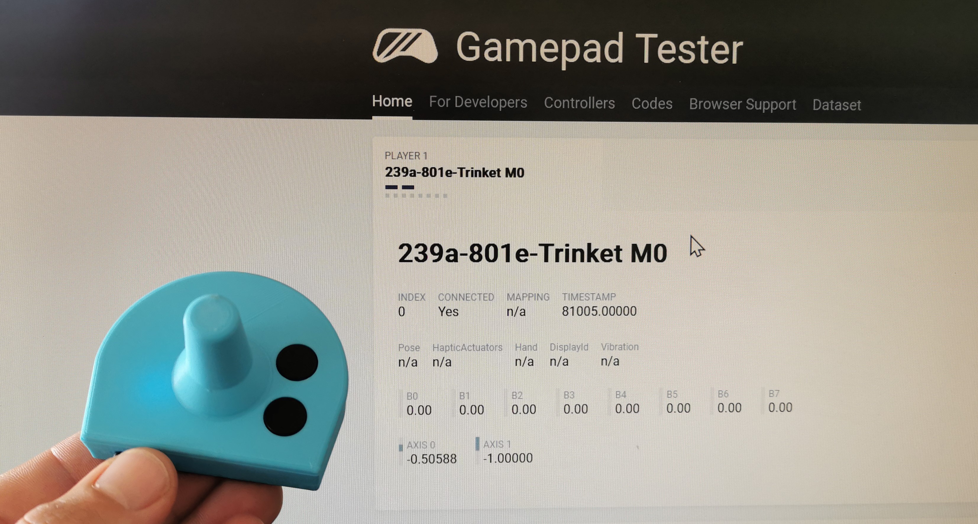

Connect the usb cable : Micro B Male on the Trinket and USB 2.0 Male in the PC
In the arduino's IDE, open the arduino sketch Joytostick_TRINKET_M0_v2.ino
Be sure to set the USB Stack to TinyUSB
Upload the sketch to the Trinket
Check it proper functionning by using Gamepad tester website.
The values corresponding to AXIS 0 and AXIS 1 will vary according to the movements of the device, it means it works.
