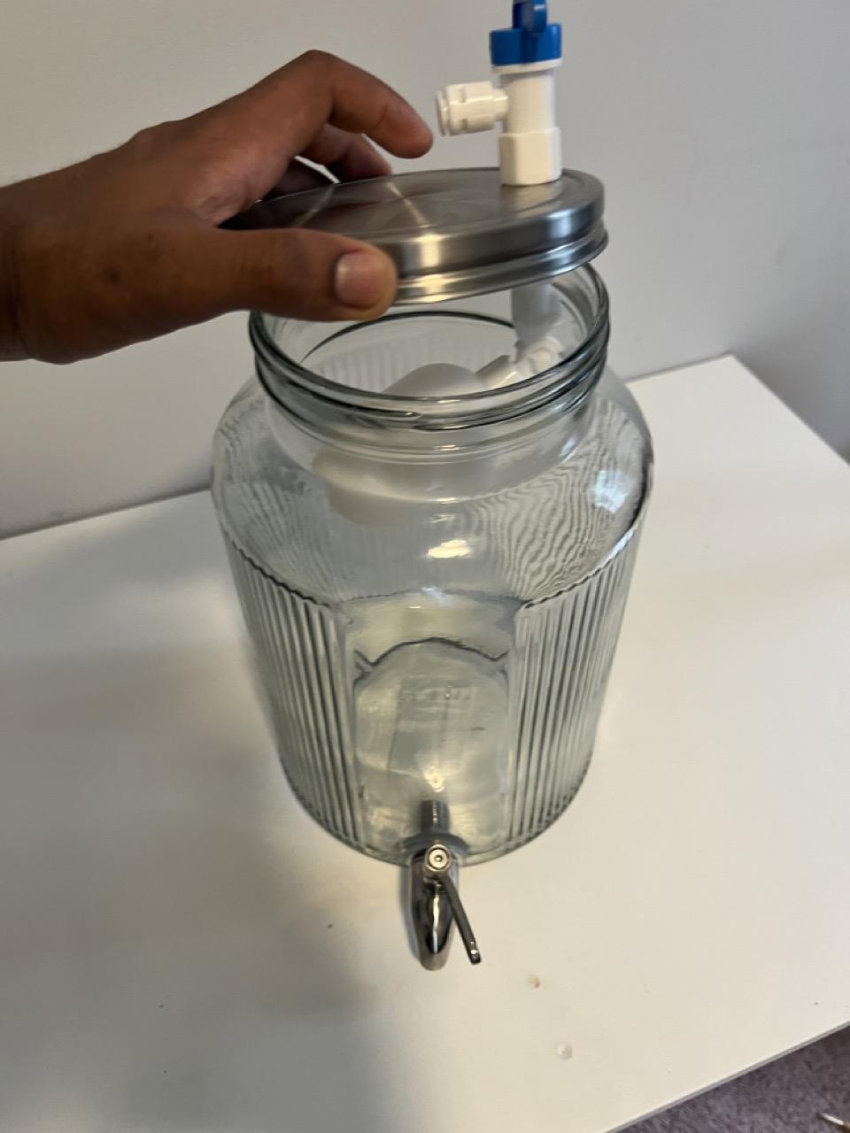

Step 8: Jug of Plenty-1
Because we're filtering the water, the water flow rate will reduce significantly. So, it can take several seconds to fill up a glass, which is unacceptable! The jug of plenty solves this problem by providing a local reservoir which can fill a glass in a few seconds.
To start with this, we puncture a hole in the jug lid and attach a threaded valve connector to it.
Step 9: Jug of Plenty-2
The float switch is connected to bottom of the lid, and a valve is connected to the top as shown in the pictures above.
Step 10: That's All!
Now, just connect your clean water line to the valve on the jug and that's it! Once you open the valve, the jug should start filling and automatically stop once the float switch lifts up.
WARNING!! Relying on the float switch alone can be a water leak risk if the switch fails. I tend to close the manual valve out of habit, and the float switch is more of a safety in case I forget to close it. If you have thoughts on how to make the system safer, I'd love to hear them!
