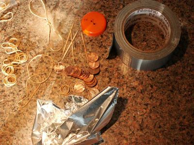

Step 3: Build the Rubber Motor
Loop recycled rubber bands from your daily newspaper together to make a strong rubber motor longer than than the jug.
Wrap a stack of 15 pennies in reused and recyclable aluminum foil, and duct tape this weight to the center of the rubber motor.
Stick one end of the rubber motor through the cap hole.
Using a wire or string, pull the other end of the rubber motor through the bottom of the jug.
