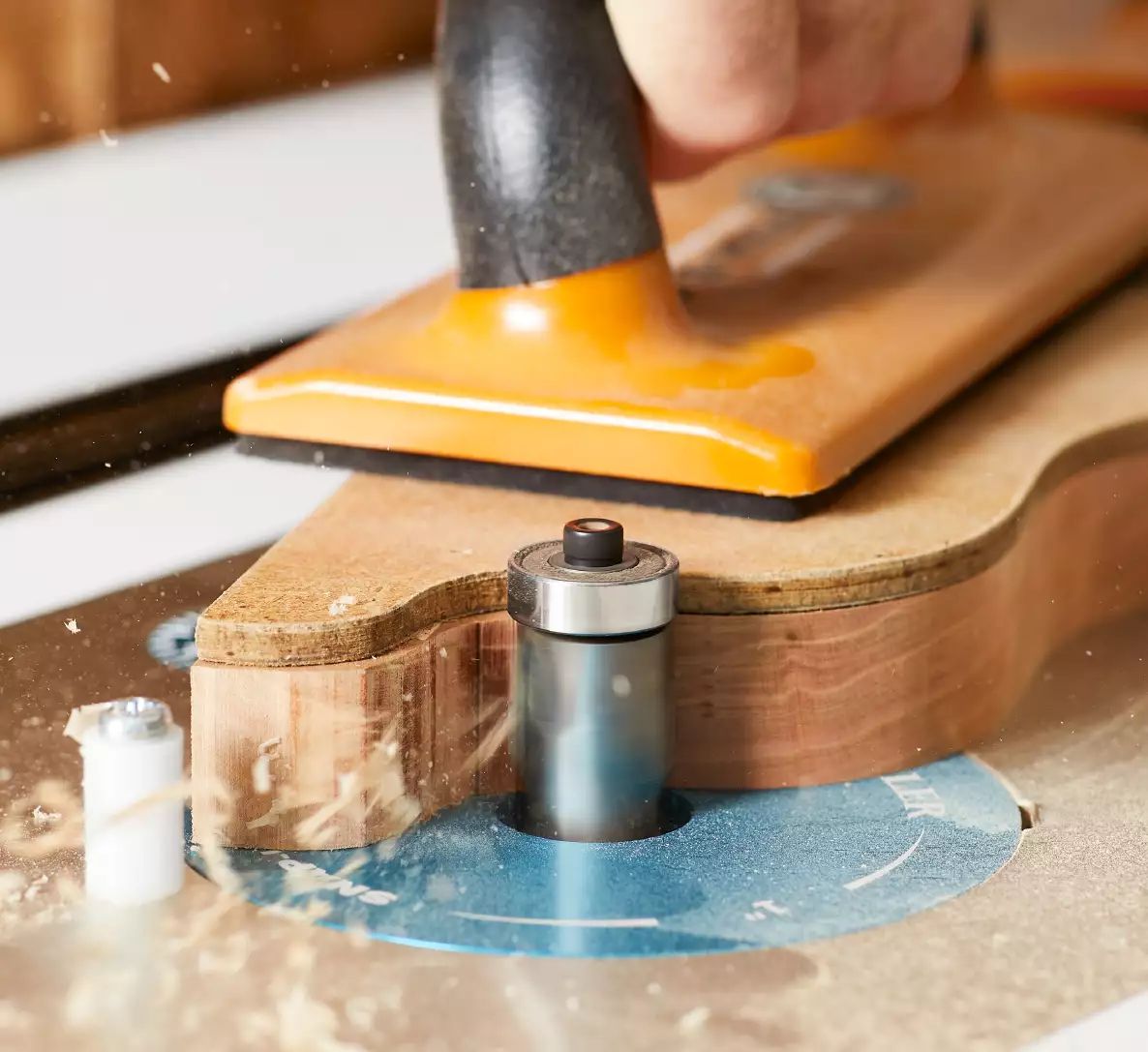

Step 6: Trimming the Edges
The parts still have some pieces sticking out where the tabs used to be. To smooth these out, you'll need to use a handheld- or table router with a flush trim router bit.
