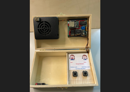

The idea of ​​the Jukebox
Children love surprises, e.g. a "miracle box" that plays a melody as if By magic. I tried that - the success was sensational. The Jukebox from the Wunderkiste knows many melodies to sing and bounce children. The effort is worth it.
But also regardless of the "miracle box", it is sometimes desired that a player automatically starts when the power supply is switched on. For example for a warning, an important error message or another announcement. Of course, he has a function to play the first jingle. The problem is: If you switch on the DFPlayer, it needs about 2s to be ready. Only then can you start an MP3 file. This process has to be automated.

This means that the small device is fully built and functional. It has an switch that is set up in such a way that it turns on when the "miracle box" is opened and two buttons for operation:
• Buttons SW2 is pressed briefly, To play the next jingle (press briefly) or increase the volume (Press longer).
• Taster SW1 reduces the volume (press short) or play the previous jingle (press longer).

For my purposes, I connected four AA batteries to a 6V bundle. The device is supplied with a stepdown converter LM2596S, which is set to 5V.
And now I wish you and especially your children and their friends a lot of fun with "music on the miracle box"
