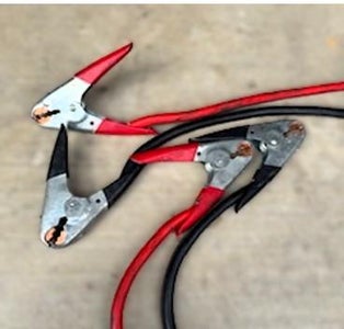

NOTE: Ensure AT ALL TIMES unused ends of jumper cables are not contacting each other or either vehicle while making connections.
NOTE: Positive (+) ends of jumper cables and battery posts are usually labeled positive (+) and colored red. Negative (-) or grounding ends of jumper cables and battery posts are usually labeled negative or grounding and colored black. See Figure 1 Above

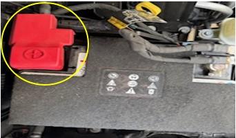

Step 8: Check for Post Coverings
Some vehicle batteries have plastic or rubber covering over the posts of the batteries for protection from corrosion. See Figures 2 and 3 above are of 2 different batteries from 2 different vehicles with 2 different types of covers over the positive (+) ports (circled in yellow.)
Step 9: Remove or Open Post Coverings
Remove or Open post coverings if the vehicles have them. See Figure 4 Above of the opened/ removed post covering.

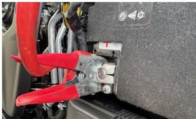

Step 10: Connect Positive Cable to Positive Battery Post
Connect the positive (+) red end of the jumper cable to the positive (+) battery post of the discharged vehicle. See Figure 5 above

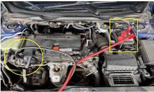

Step 12: Connect Negative Grounding Jumper Cable to Grounding Post
Connect the negative (-) grounding black end of the jumper cable to the negative (-) grounding black post of the booster battery. See Figure 7 above
Step 13: Identify Good Engine Ground of Discharged Vehicle
Identify a good engine ground (exposed metal part of the discharged vehicle’s engine away from the battery and fuel injection system).
Step 14: WARNING!
WARNING: Do not connect the jumper cable to the negative (-) post of the discharged battery. The resulting electrical spark could cause the battery to explode and could result in personal injury. Only use the specific ground point, do not use any other exposed metal parts.
Step 15: Connect Grounding Jumper Cable to Identified Engine Ground
Connect the opposite end of the negative (-) grounding black jumper cable to a good engine ground (exposed metal part of the discharged vehicle’s engine) away from the battery and fuel injection system. See Figure 8 above
