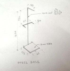

  1. Picture 1: ☐A rigid frame made as per given sketch . I recommend steel or stainless steel as it will be sturdy and will not waste micro movements. Get it welded in an welding shop.
  2. ☐steel plate for base, as per picture.

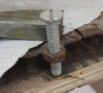

  3. Pic 2: ☐3 nos bolt+nut for adjusting the platform elevations and angles. Use M4x30mm or similar

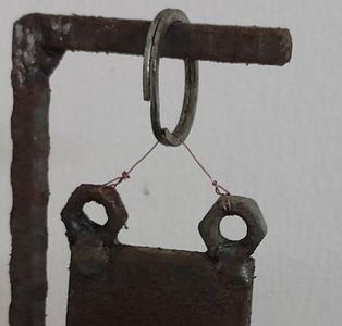

  4. Pic 3: ☐hanger for weight: one keyring, ☐two nuts. (Or use similar, but make sure it can hinge horizontally but not rotate around vertical axis)

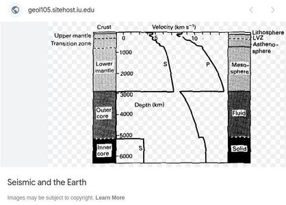

Step 1: Theory

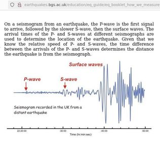

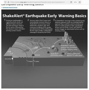

  • Earthquakes have multiple kinds of waves. As you can see in the first picture, The small "P" waves comes much earlier than large "S" waves. The most damaging are surface wave which come later.
  • The reason is the P waves are compression waves which travel at 6 km per second speed and S waves are shear waves which travel slower at 4 km/s.
  • But the P waves are very small in amplitude. So People cannot feel this. but I suspect that animals can feel this. So we often find them perk up and howl before earthquake arrives . So if we make a device that measures this small movement, we can detect the P waves.
  • Now if your nearest earthquake source is 400km away. Then the time you have is 400/(6-4)=200 seconds. which is 3 minutes 20 second. This can be enough time to run down the stairs and reach open grounds.

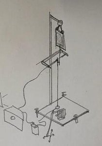

  • See the pictures above for references. Left one is conceptual and the second one is of the equipment.
  • A weight "W" is hanged from a hinge. This weight be a scrap piece of steel. A small steel stick is also welded below the weight. Then if "W" moves by "x" micrometer, then the tip of the stick moves by 2x as it is approximately 2 times away from the hinge than the center of "w"
  • Now another steel G.I wire of 150mm is hanged from another hinge to multiply the movement even more. Then the tip of"w" is attached to the GI wire at a distance of 2mm from the hinge. So this multiply the movement by 150/2=75 times.
  • Total increase in movement=2*75=150 times.
  • Now the tip of the GI wire is put inside a round loop or wire. the gap is 0.75mm. If the Gi wire moves by 0.75 mm in any direction, then the circuit of the beeper is complete. This will make the alarm go on.
  • So the needed movement of pre-earthquake shake is is 0.75/150mm=0.005mm or 5 microns. Then this Thing will work.
  • As given in the last image of a real earthquake, the P wave gives a 5-25 micron movement which should trigger the alarm in a continuous fashion. The sound should be a continuous beep-beep-beep for 1 second or so. Any less sound can be a false alarm that can happen if the assembly is not covered.

  • Keep the total height of the equipment around 300mm. 120-150 mm from top-most part to the connections at mid section. And 150 mm midsection to the bottom plate.
  • Make the steel support out of 4 mm thick steel bars. Use Scrap metals if you wish.
  • Hang the weight as shown.
  • You can adjust the distances by moving the ring along the top bar.

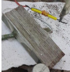

  • We need to electrically connect the hanging GI wire to a circuit. So solder (not weld) the GI wire to 3 strands of an insulated copper wire seen in blue. The left side of the blue wire is connected to the black wire.
  • the blue wire should be fixed to the support by means of GI wire and loose copper wires as shown.
  • Connect the Steel spike of the hanging weight to the GI wire at a 2 mm distance by a 0.3-0.5mm copper wire as shown.

  • the tip of the GI wire should be a material that can resists small sparks. So i chose a graphite tip of a pencil. Graphites are also used in motor brushes for similar reasons.
  • A loop is made of a small hoop made in the copper wire.
  • the copper wire is set at place by a bent GI wire and a steel block of weight. you can also select paperweight for this.
  • The bottom of the GI wire is connected to a painting brush for adjustment. Put a white paper below the loop so you can see clearly and adjust.
  • There are three adjustment screws and welded nuts on the platform to adjust slope of the equipment. See hand-sketches in step 2.

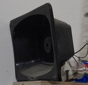

  • Connect the circuit after putting the equipment on a stable platform. Use a plastic container to focus the sound

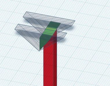

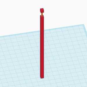

Step 9: Making the Parts

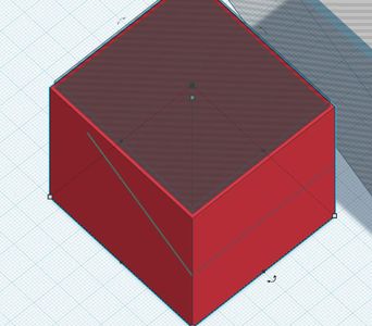

  • Used tinkercad to make the mechanisms.

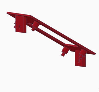

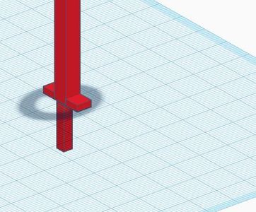

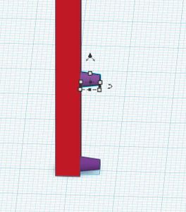

  • First the bottom rod is made as shown in the steps. This will hold an accelerometer MPU9250. The parts are to be updated as per dimensions of the MPU9250.
Step 10:
  • Top rod is also made similarly.
  • It needs to hold weights and rest on a hinge.

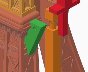

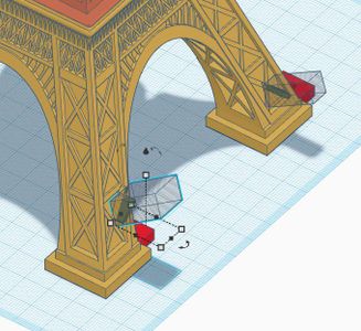

Step 11: Structure

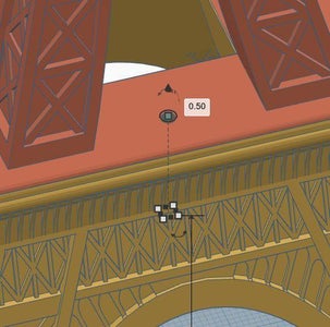

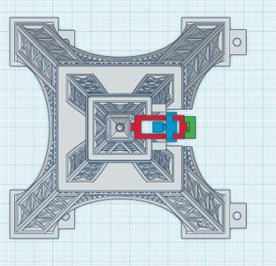

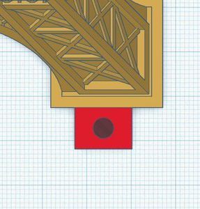

  • The structure is made from a model of the eiffel tower. The model original is from this location: https://www.thingiverse.com/thing:3577783
  • If the eiffel tower cannot be imported due to its size, it needs to be scaled down.
  • It is cut to give space for the rods
  • Some finishing is also required for the model.

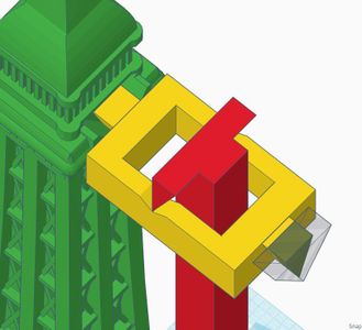

Step 12: Tower Setup
  • We have to make two hinges at 90 degree angles for movement in two directions.

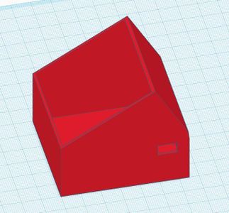

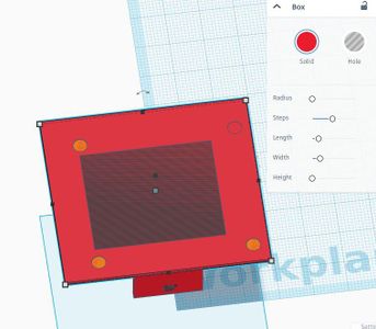

Step 13: Display Box
  • The display box is made as per dimensions of the parts to be kept inside.
Step 14: 3d Files for Print, PartA
There are two versions of this file:
PartA: full scale model based on the main apparatus.
PartB: half scale model which is faster to print, but will not be very sensitive.

Step 19: Fix the Pendulums
  • Fix the 3d printed pendulums as shown
