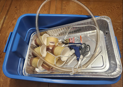

Materials needed to re-create this project are:
-water pump, air pump, or a small fish tank filter
-air pump tubing (if you are using an air pump instead)
-fish tank substrate cleaner tubing
-2 large water bottles or a plastic tub/bin
-a aluminum takeout-box (any box should do, but it will need to be waterproof or waterproofed)
-throw-away cups (paper or plastic ones will do)
-clay balls, wood chips, or any other inert growing media
-hot glue gun + glue sticks or any other adhesive/sealant
-a custom or interval outlet timer

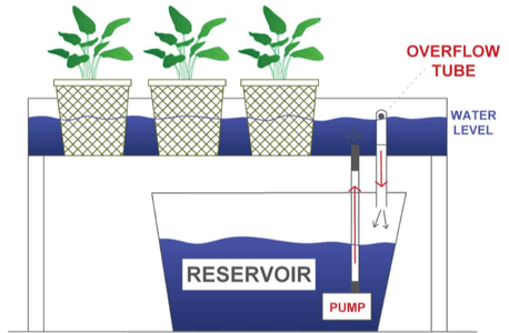

In this instructable, I will be using the ebb and flow system, since it will be the most viable method to create with the materials on hand, while also being extremely effective at delivering nutrients to the plants. An ebb and flow hydroponics system is a popular method of soilless plant cultivation. It consists of a growing bed or container filled with an inert growing medium (nutrition-less) where the plants' roots are placed. The system operates by intermittently flooding the growing bed with a nutrient-rich solution and then allowing all of it to drain back into a reservoir. The cycle's frequency typically ranges from a few times a day to once every few hours, depending on factors like plant type, growth stage, and environmental conditions. If you have a custom timer, you can set the flood session for about 2-5 minutes, but with an interval timer, just set it to one interval long. A benefit of the ebb and flow system is that the drainage tube allows for the water draining back into the reservoir to be oxygenated without the need for an additional air pump/stone.
Diagram Credit: https://www.backyardgardenlover.com/ebb-and-flow-hydroponic-system/

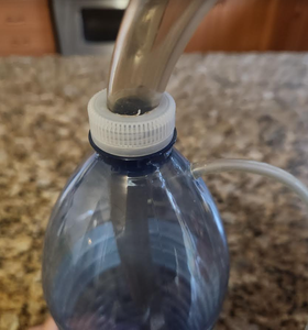

Step 4: Creating the Water Pump (if You Don't Have a Water Pump)
This step is only for those who want to make this system using an air pump. The design of this pump included using a 1.5L water bottle (any large soda bottle would do) in order to act as the reservoir for my system. A tube will be connected from the bottle to the aluminum box to allow for the delivery of water. The air pump will also be connected to the bottle via another tube as well, the delivery of air into the bottle will displace water out of the bottle through the tube connecting to the aluminum box via the cap of the bottle. This is demonstrated in the video provided.
Start by drilling out a hole on the cap of the bottle that is slightly smaller than the diameter of the fish tank cleaner tube. This will allow for a better airtight connection without the need for large amounts of additional sealant/glue. Slide the fish tank cleaner tube through the cap of the bottle until the end is about 1 cm from the bottom of the bottle. Drill another hole near the top of the bottle on its side way with a diameter that is once again slightly smaller than that or the air pump tube. Slide the air pump tube through the hole so that about 1 cm of it sticks into the bottle.

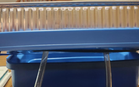

Step 8: The Drainage System
Drill a second hole on the bottom of the aluminum takeout box slightly smaller than the width of the fish tank cleaner tube. Insert the fish tank cleaner tube to the takeout box and make sure it either feeds back to your water reservoir, or another bottle if you are opting to use an air pump instead. Furthermore, make sure that the height of the tube protruding into the base of the takeout box is about 1-2 cm below the top of the takeout box (or where the raft will be).
If using an air pump, make sure the secondary drain bottle is set up identically to your reservoir bottle (Step 4), as this will allow you to easily switch the bottle between flooding sessions instead of having to re-fill the reservoir bottle every time. Follow the same steps to connect the tube to the takeout box as described above.
It is also important to keep in mind that the drain tube has to be as big or larger than the flood tube so that the water entering the system does not overtake the rate at which it drains. When the cycle ends (when the water pump turns off), the rest of the water below the overflow tube line will drain through the backflow to the water pump, or to the initial reservoir bottle through the backflow of air through the air pump. It is important that the water fully drains from the takeout box to allow the plant's roots to have adequate exposure to oxygen. The "ribbed" bottom surface of the takeout box should also help with preventing small pools of water remaining at the bottom of the takeout box as well.
