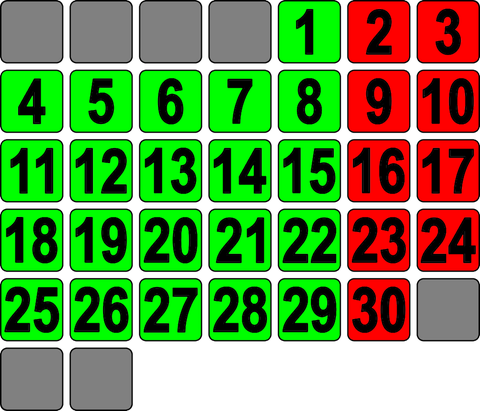

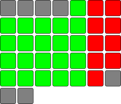

Now if the week starts on Monday:
We see that November starts on a Friday (the first day before the weekend, the 5th day of the week, the first week is three days long), has three full weeks (meaning all seven days), and the last week ends on a Saturday (the first day of the weekend, the 6th day of the week, the last week is six days long).
So even without any numbers displayed, we can firmly state that November has 3 + 21 + 6 = 30 days (same result as above) 🙂

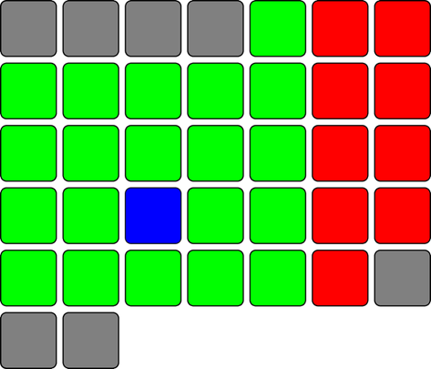

Displaying the current day in blue...
The third day of the 4th week of the month is 3 + 14 + 3 = 20th November (the first week has 3 days + 2 full weeks + the day of the week). Just as simple, isn't it? 🙂
