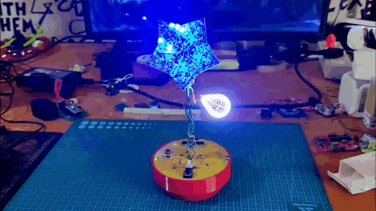

So Here's something Super Cool and unique, A Flower Pot made completely out of PCBs.
I made this flowerpot by combining three different PCBs, I used a diamond-shaped board as a flower petal by soldering them together in star-shaped form.
This project is a combination of electronics and art by pushing the limits of how and where we can use PCBs in so many different things.

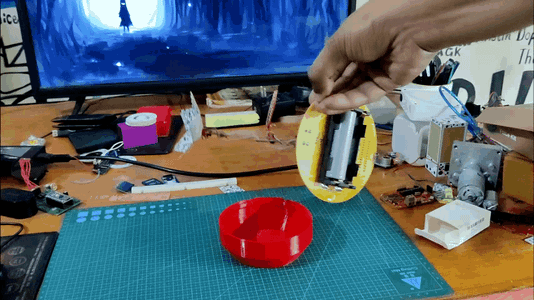

  • 3D Printed PCB HOLDERs
  • 3D Printed Vase

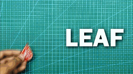

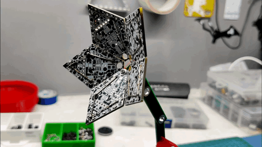

I used a previously made PCB as a leaf because its shape was somewhat similar to an actual leaf.
As for the stem, I prepared a PCB that holds the flower and leaf together, this stem is then soldered on a base that holds the whole structure and also contains the control board.
I've added LEDs on Petals and Leaf, these LEDs connected are in parallel. LEDs on each PCB are connected in parallel, they are all driven by six MOSFETs that are on the Base PCB.
These Mosfets are controlled by an Atmega328PU, we can turn them ON-OFF in sequence or dim them down or do some fading effects on them.
As for the Power, I've added a Boost IC Setup on the base that boosts 3.7V from the Lithium Cell into 5V for powering the LEDs and Microcontroller.

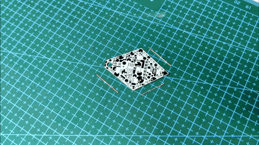

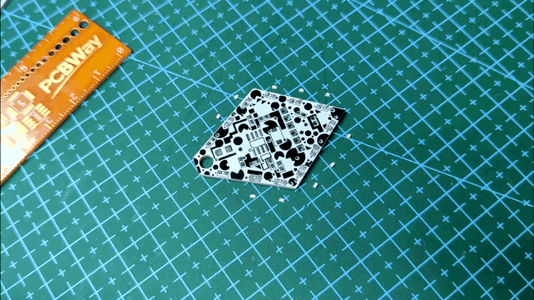

This idea came into existence almost two weeks ago, I prepared a diamond-shaped PCB necklace, and after finishing the project I noticed that it could be aligned side by side in a polygon shape, a pentagram to be specific.
So I taped five diamond-shaped PCBs together and made a PCB Flower just to visualize the idea.

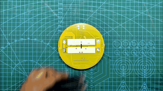

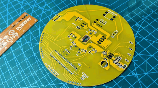

Step 4: PCB DESIGN of Main Board
After finalizing the schematic, I prepare the PCB Design of the base board by using a 100mm Circle as an outline and putting all the components inside this circle.
I've added a Slot in the middle of the PCB, This slot will hold the STEM PCB, I also added all the MOSFETs setup around this slot so it would be easy to connect the LED section with each of its MOSFETs through connecting wires.

I Choose a Yellow soldermask with white silkscreen for the Base Board and Green Soldermask for STEM Board.
I received PCBs after a week which was super fast. As for the PCB Quality, it was super good.

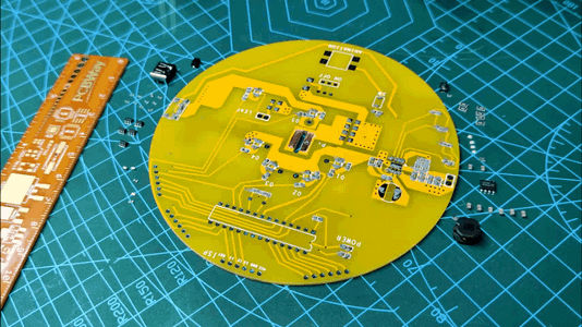

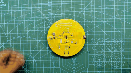

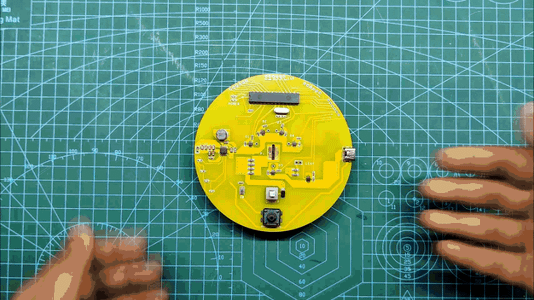

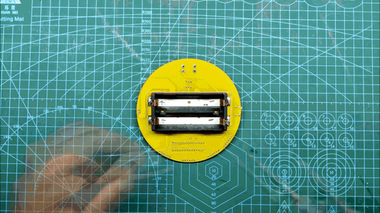

Step 7: Base Controller Board Assembly

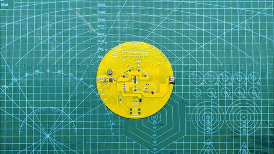

  • I first started the Base board assembly process. first, we add solder paste to each component pad one by one with a solder paste dispenser.
  • We then gather all the components and place them in their place.

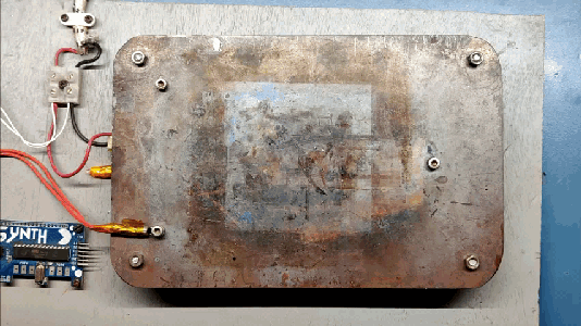

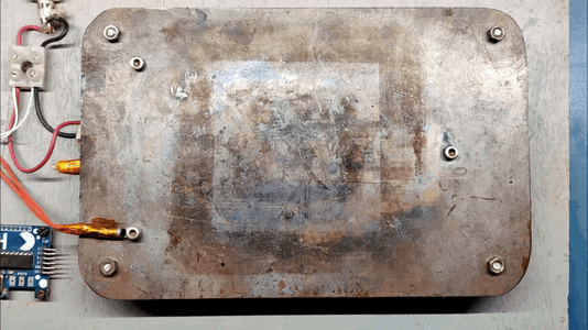

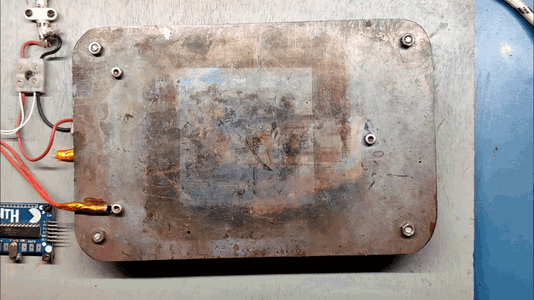

  • Next, we add the PCB on an SMT Hotplate that heats up the PCB from Below up to the solder paste melting temperature.
  • Later, I added SMD Lithium Ion cell Holder on the bottom side
Step 8: Base Controller Board Testing

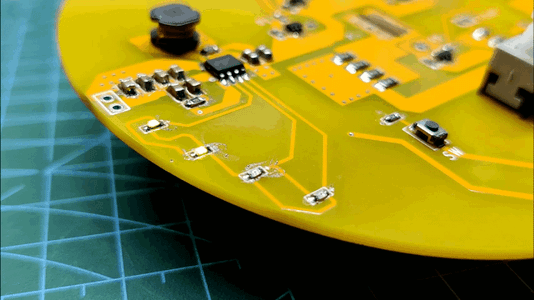

The next step is to test the Boost module setup, so I added a Lithium Cell to its SMD holder and turn ON the setup by using the SMD Switch on the board.
This triggers the IP5306 IC and its indication LEDs glow up indicating the battery percentage.
We measure the output voltage of this setup by using a multimeter, the output voltage was 5V which indicates this part of the base board is working properly.
Next, we add a Type C Charger to this setup in order to check if the indication feature is working or not.
IP5306 has four LED-based indication feature that shows the battery percentage of 25% 50% 75% and 100%.
After testing the Power management setup properly, we move on to the next step which is to add THT Components to the base board.

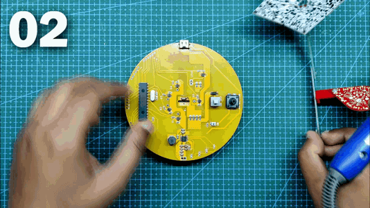

Step 9: Adding THT Components
Next, I gather all the THT components and started the THT Assembly by placing them in their right place and then soldering their pads using a Regular soldering Iron.

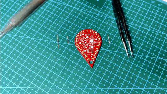

Step 10: Leaf PCB Assembly
For the Leaf PCB Assembly, we first gather 24 White 0603 LEDs and start by adding solder paste to the LED Pads on the PCB.
Next, we Pick and place each LED and then use the SMT Hotplate to melt the solder paste.

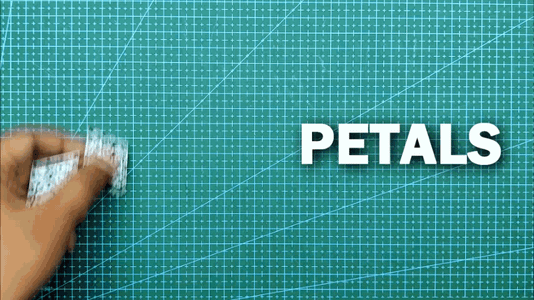

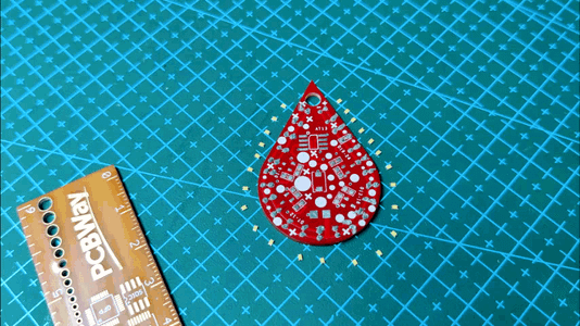

Step 11: Petal PCB Assembly

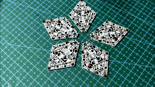

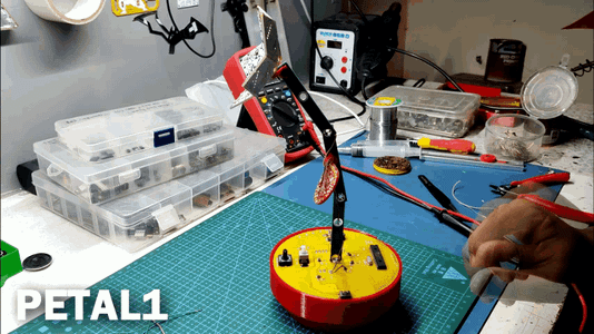

For Petal PCB Assembly, I used 12 Blue LEDs of 0603 Package and start the assembly by first applying solder paste to LED Pads on the PCB.
We then pick and place each LED in its assigned place and put the whole board on SMT Hotplate for reflow.
Because we are preparing a Pentagon Flower, we need to prepare a total of five boards.
Step 12: Editing Part in Petal and Leaf PCB
Next, We connect all the LEDs in parallel by using a few jumper wires to connect their negative together as in the previous board, six LEDs were connected in parallel and they were driven by a single mosfet and I've used four Mosfets to control four sections of LEDs so its important to connect all LEDs in Parallel by connecting their negative terminal together.
We do this process in both Petal and Leaf boards and then move on to the next process which is to test each board's LED continuity.

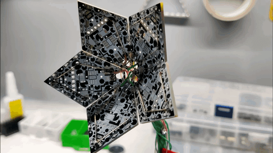

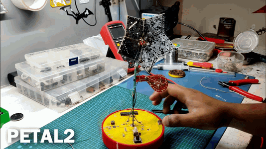

Step 14: FLOWER ASSEMBLY

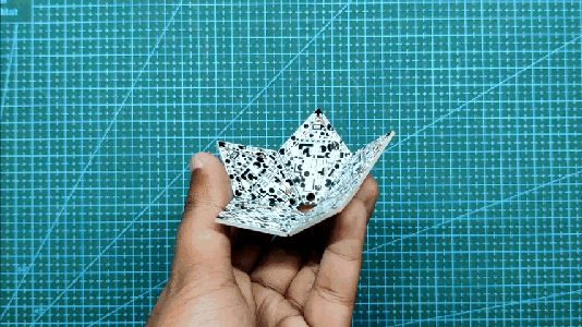

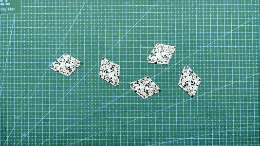

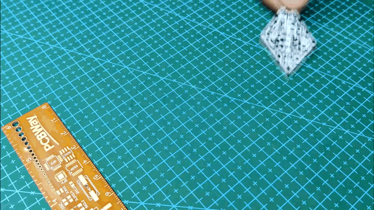

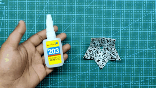

The first step is to gather all the Diamond-shaped PCBs and add tape on the back side to hold two PCBs together.
By following this method, we attach five PCBs together in a pentagon shape.
Next, we add super glue in between all the PCBs so they fuse together and make one single flower-like structure.

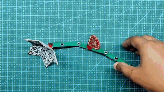

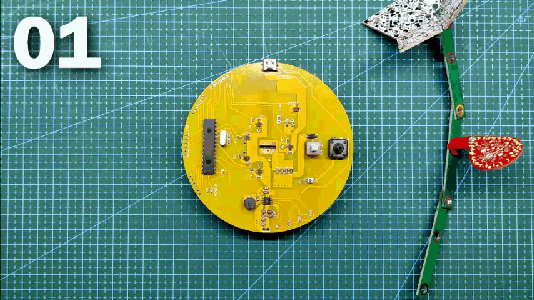

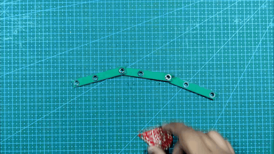

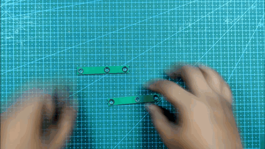

Step 15: Preparing STEM

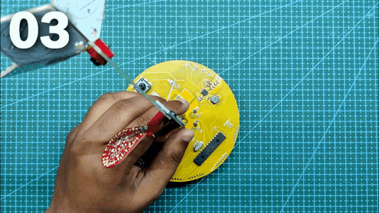

We then prepare the STEM part by soldering three STEM PCBs together in a curve pattern, kinda like an Arc made from three lines.

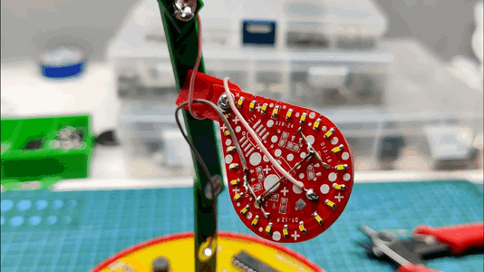

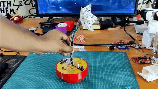

Step 16: LEAF and STEM ASSEMBLY

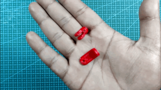

Next, we connect Leaf PCB with STEM Structure by using a 3D Printed Circuit holder that we screw to STEM PCB first and then add Leaf PCB on it.

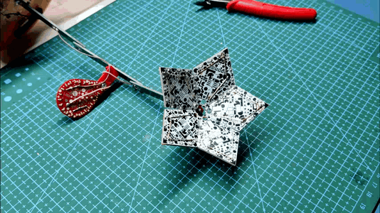

Step 17: FLOWER and STEM ASSEMBLY
Similarly, we add Flower Structure with the Leaf and STEM assembly by using another 3D Printed Circuit holder that connects STEM with Flower.

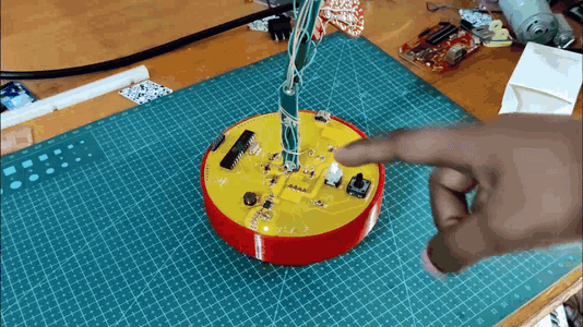

Step 18: MAIN ASSEMBLY
Next is the main assembly in which we start first by connecting the upper flower with the base by putting the STEM PCB in the slot on the base PCB, we then solder the pads of STEM PCB with Base pads and this secures the PCB in its place.
Step 19: WIRING
The last process of this build is to wire everything up.
We start first by connecting the positives of all the LEDs that are being used in the flower portion and the leaf together.
Then we connect wires from the negative of each LED Section to a mosfet Switch present on the base PCB.
There are a total of 6 different LED Sections, five petals, and one leaf. Six MOSFETs control each section and their VCC are common. GND of each LED section goes into Mosfet's Drain port.

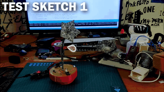

As for the code, I first used the test sketch which was a chase sketch that turns ON and OFF LEDs in a chaser sequence. This sketch was just for testing.

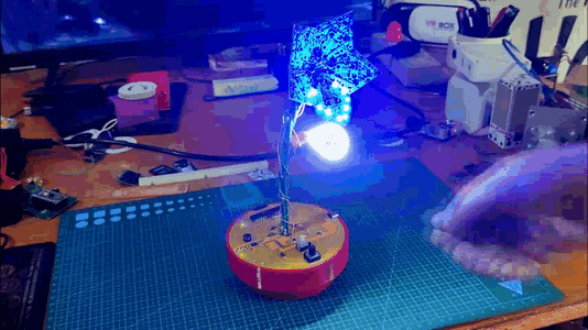

Step 21: RESULT
Here's the result of this crazy-built, OverEngineered Flower Pot that is made completely from PCBs.
We first turn ON the ON-OFF Switch that turns ON the IP5306 IC and it powers the atmega328PU MCU.
To start the LED Sequence, we use the toggle switch to start or stop the LED Animations.
This is it for today folks, stay tuned and I'll be back with a new project soon.
