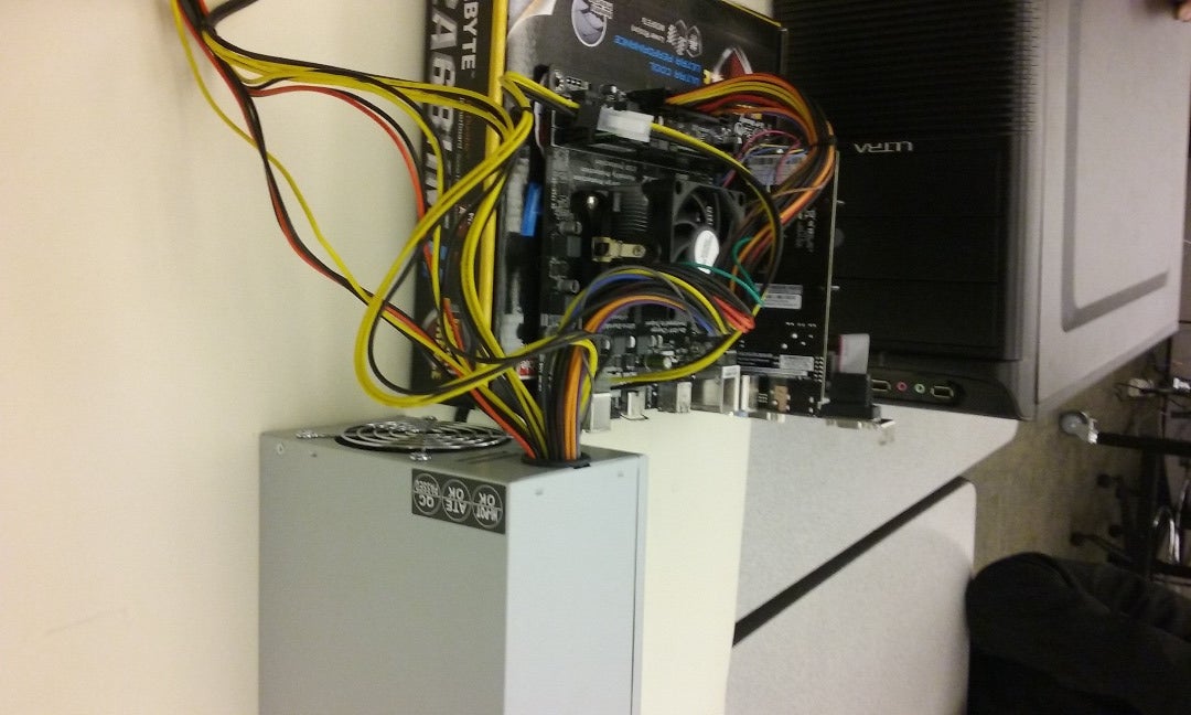

Step 4: Step 4: Testing the Motherboard and Video Cable
Now, you'll want to test if the motherboard will work before you put it into the case. You'll want to plug in the power supply and connect a VGA cord to the video card.
Now, take a small nail or screwdriver and touch the power pins on the motherboard. The CPU fan and power supply should turn on. If done correctly, A message saying there is no bootable device.

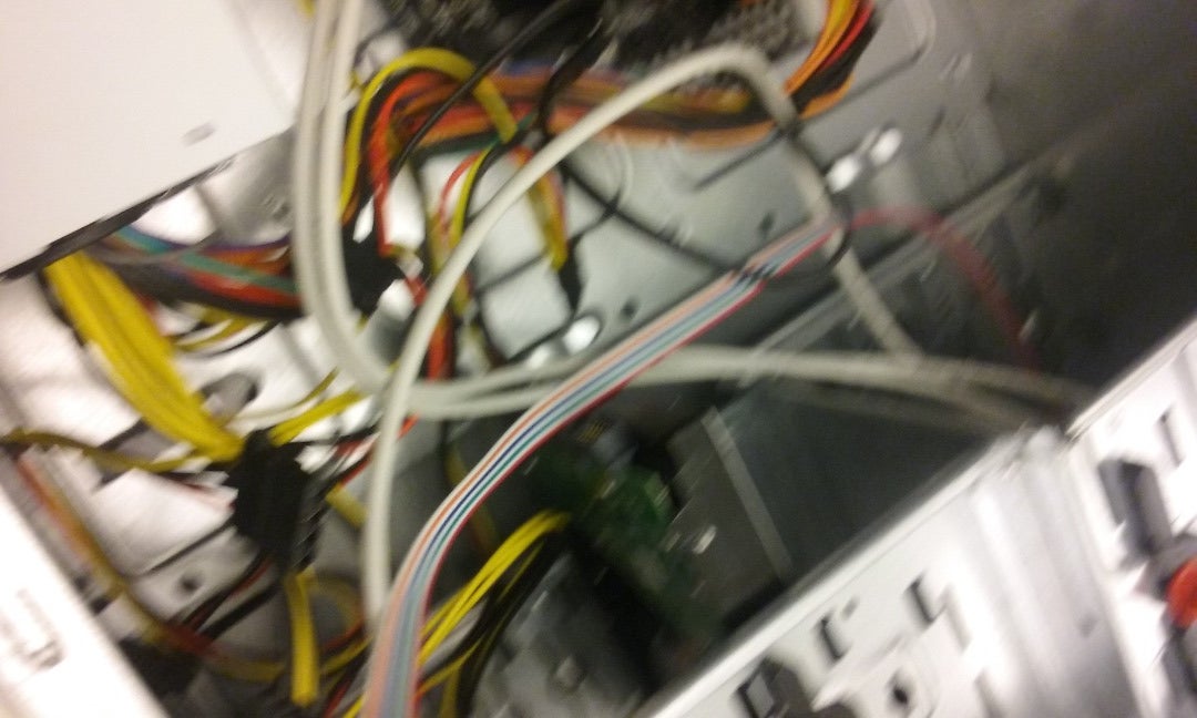

Step 6: Step 6: Plugging in the Cords From Power Supply to Motherboard
Connect the plugs you had previously connected. Once you have these plugged in, you can perform some cord management. Make sure its all neat and tidy.

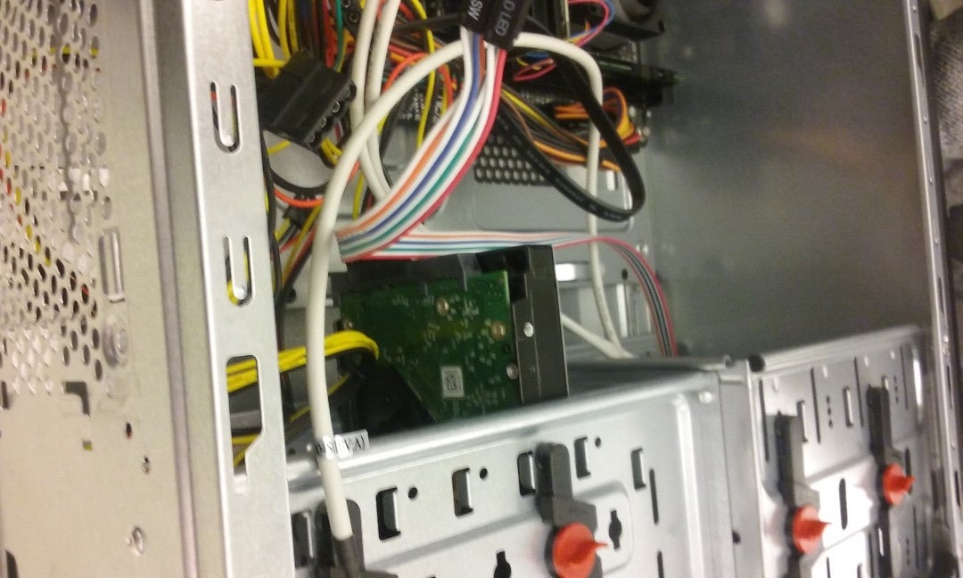

Step 7: Step 7: Hard Drive and Connecting LED Cords
Put the hard drive into place and screw it in securely. Plug the SATA cord into the motherboard. Next, you need to plug in the LED and front plugs into the motherboard as well.
