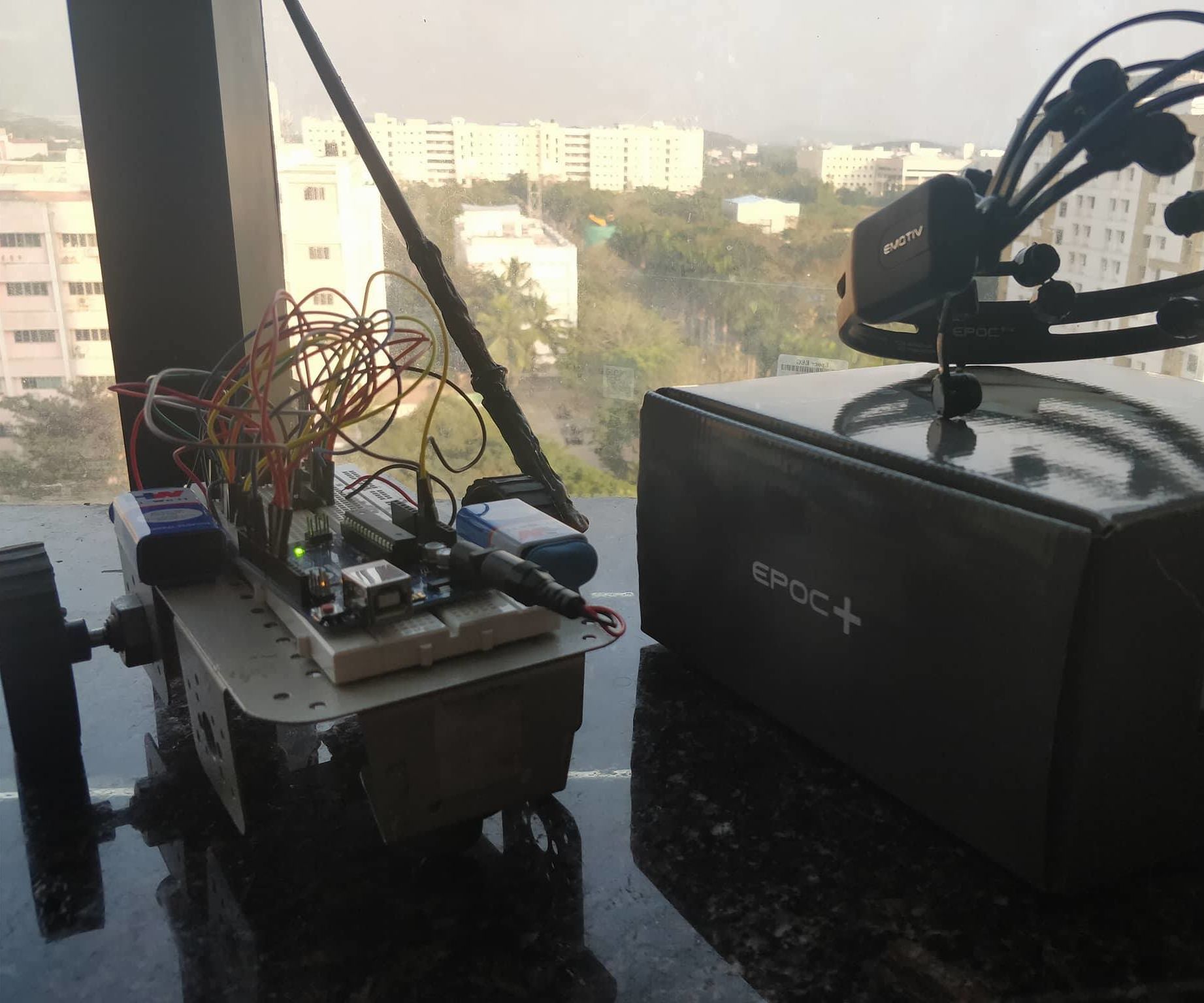

Introduction: KIVI (Leap Motion Controlled Arduino Vehicle)
Hey kiwis!
This is an Instructable on how to to construct a Leap Motion and Arduino controlled Kinetic Vehicle (or KIVI for short!). The Leap Motion Controller is a device specialized for tracking hand movements. We use the Leap to track our hand positions and convert those into instructions to move the car. The Arduino receives coordinates from the Leap Controller through an IDE called Processing, which transmits the data in form of bytes through the Serial Channel! The Arduino IDE is where we write code for what we want the Arduino to do and then the code is uploaded to the Microcontroller board!
We were surprised to find out that the Leap, being the powerful device it is, hasn't been in much use lately so we decided to have fun with it.

Step 8: HOW IT WORKS:
Now that we're done with all the connections and testing, let's understand how your KIVI works :
Processing receives the 'x' and 'z' coordinates from the Leap Motion Controller, maps them to values in the range of (-256, 255) and appends them to a string. This string is converted into bytes and sent to the Arduino via the Bluetooth Module.
The String received by the Arduino is parsed into Integer. The circuit is mapped such that the positive and negative values in the Z-Axis control the direction of the KIVI, i.e., forward or reverse. For this to work, we pass the values we receive through the H-bridge, which directs the motor spin. For more details, refer to the following guide:
http://www.modularcircuits.com/blog/articles/h-br...
The positive and negative values in the X-Axis steer the vehicle. This is achieved by appropriately regulating the speed of the individual wheels. (Refer code)
We have also implemented Gesture Control where we used the Leap Motion Sensor's functionality of detecting various features (here, the Grab Strength) to implement Braking.
