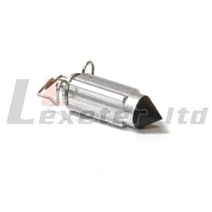

The first thing you'll want to check will be the float valve. The float valve can gum up after being set up for a while. To remove the float valve you need to push the pin out that connects the float to the carb. It should push out with a little effort. Be gentle though, if you try to bang it out, you're likely to break one of the mounting pegs. If you look at the picture of the float valve, it has a very thin wire that connects it to the float. It's a free floating piece, but the bowl secures it in it's position. If you remove the float valve and examine the pin that extends from that valve doesn't spring out, you'll likely need to replace this part. There is a trick to getting these working again. Replace or repair, up to you.
http://ecx.images-amazon.com/images/I/31TF8Ts43KL....
Image of a carburetor float valve.
