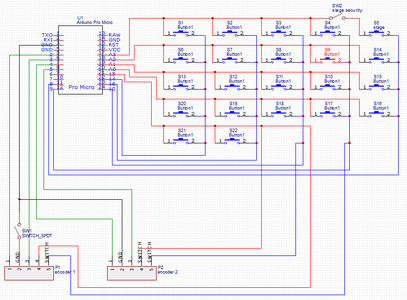

Step 4: Soldering !
place the buttons in their respective holes and start wiring according to the schematic
