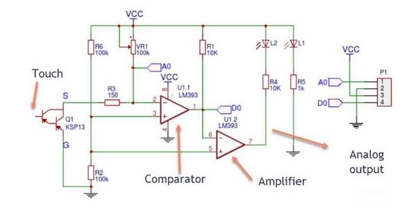

Step 2: Module Electrical Schematic
Step 3: Module Interface Description
Module interface description (4-wire system)
(1) AO board analog signal output (voltage signal)
(2) GND connected to the negative pole of the power supply
(3) VCC connected to the positive pole of the power supply 3.3-5V
(4) DO TTL switch signal output (0 and 1)

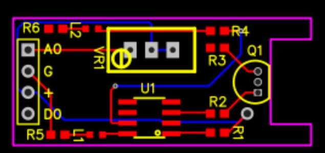

Step 4: Module Small Board PCB
Module Small Board PCB Size: 3.2cm X 1.4cm
