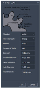

  4. The gears required some trial and error. I used Fusion's Spur Gear add-in. The settings I used for the smaller, motor gear are in the attached screenshot. I plugged in the same Module and Pitch Diameter of the kaleidoscope gear into the Module formula to get the correct number of teeth to use.
