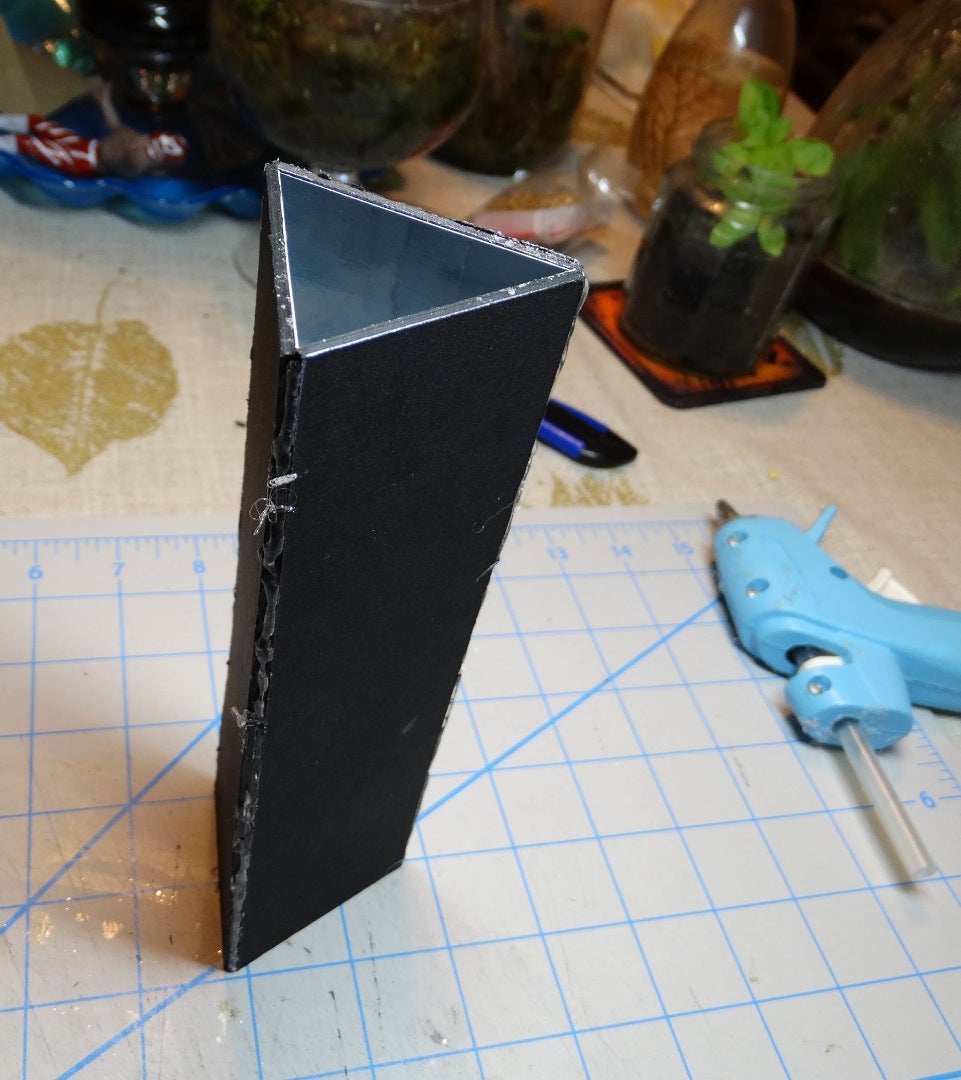

Step 4: Triangle Assembly
Rest your pieces together on a flat surface, forming a (more or less) equilateral triangle.
Hot glue seemed like the most logical way to bond the seams tightly. To ensure there were no gaps, I worked inch by inch.
Holding your triangle sides steady, apply an inch or so of hot glue to the top seam. Press the sides together gently until dry.
Repeat all the way down seam, pressing as you go. You want the seams completely sealed and all external light blocked out of the triangle.
When the first seam is dry, flip your triangle over once clockwise. Adjust the sides as needed to keep that equilateral triangle in check. Repeat the hot gluing process; glue a segment, then press.
Flip one last time and repeat for the third seam. When you're finished you should have a nice, sturdy triangle tube.

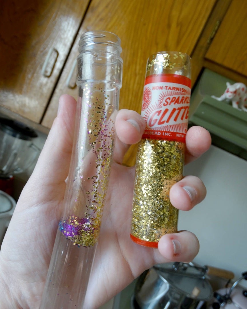

Filling combinations are nearly limitless. Consider different weights of loose glitter (chunky, regular, ultra fine), shaped metallic confetti, and even small seed beads. Heavier items like beads will fall quickly, but they do add visual interest.
Glitter glues are a great addition to your cartridge mixes. The glue will break down in the water but will remain a bit viscous, causing a different sort of motion than loose glitter. You will notice your glitter stays suspended a bit longer than loose glitter alone.
You want to fill each cartridge with a variety of not only colors, but weights and consistencies.

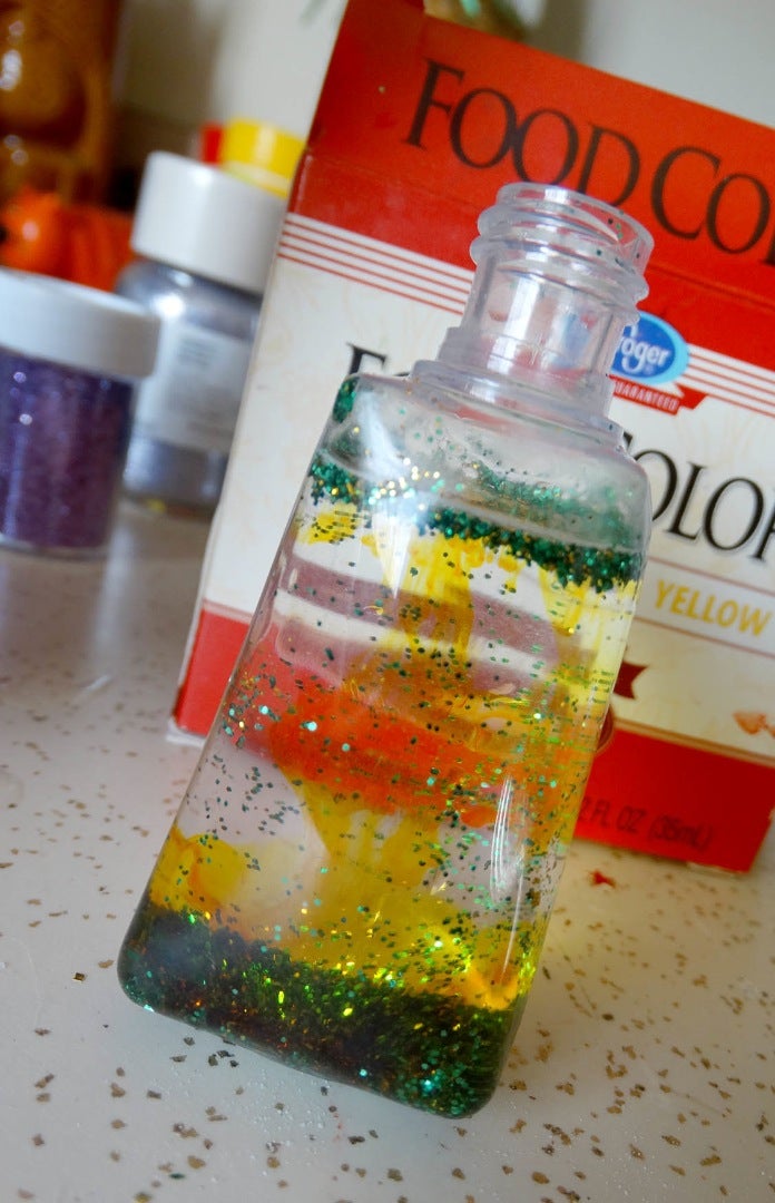

Step 10: Filling Suggestions
I encourage you to play around and find your own methods for mixing. It's part of the fun with this project. Here are a few tips I have to give after mixing several cartridges myself:
Glitter Glue squeezed into water will look like little organs preserved in a science lab jar.Don't fret! Just shake it up (or don't! Try looking at this globs through the kaleidoscope and see if it gives you a lava lamp type effect).
If you don't have glitter glues, you can add regular school glue (white or transparent) to a water + glitter mix to add some viscosity. Using warm tap water in your container will help break up the glue.

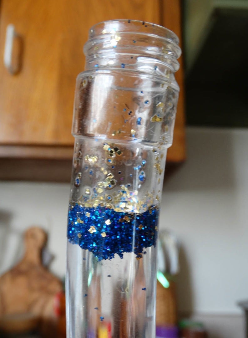

Add a little glitter, add a little water. If you totally fill your container with water first and then try dumping a bunch of glitter in, the glitter may fail to break the surface tension of the water and just pile and up and out (all over you).
Cap your container and Shake after each addition. This will get things mixing properly and also show you where your chosen color combo is heading.

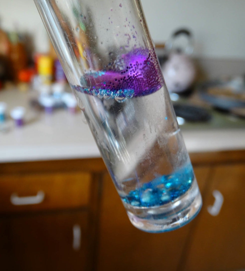

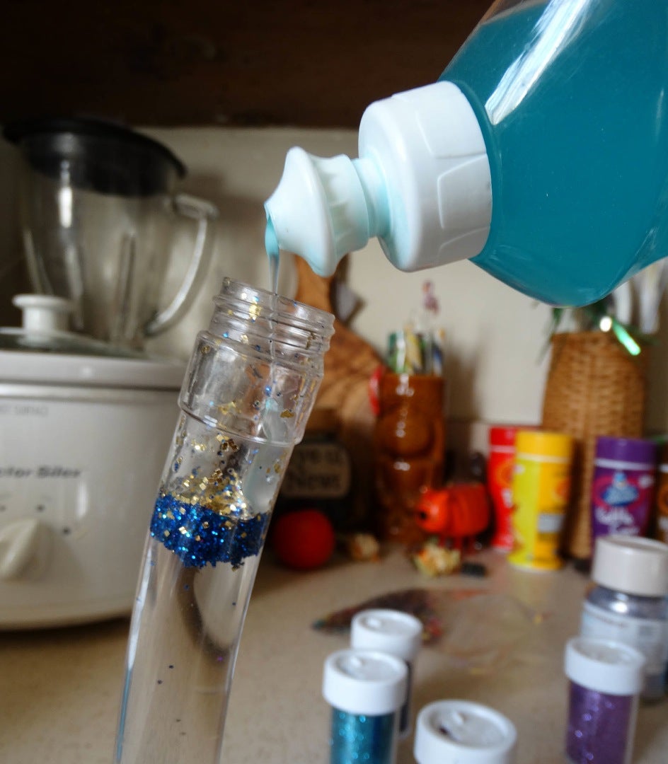

Using straight Water + Glitter? If you find that all your glitter just wants to clump at the surface (10th photo), try adding a drop or two of liquid dish soap. The added viscosity changes the way the water behaves, preventing glitter clump ups and making contents fall a little slower. You may get a few bubbles when shaking, but you can take the cap off and let them dissipate.

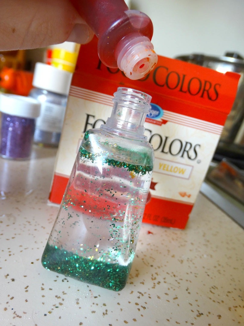

Try using a few drops of food coloring to tint the water. No special tricks here, just another way you can layer more color into your mixes. I found that some glitters leak their color when in water for a while, and will end up tinting the water for you.
