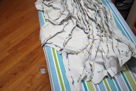

I pulled out the mess of pattern pieces for Kali's front and laid it out on the ironing board. And then I stopped.
My ironing board has a striped cover over its very worn base. The cover helps a lot and I didn't have another one on hand. Unfortunately, the stripes in combination with the many pieces of jumbo spandex was a little dizzying. Making a new one wouldn't be hard, but it would take valuable time. Not to worry! I had a bin of old clothes ready to use as fabric or to donate. A stained old orange hoodie fit the bill.
I pulled the hoodie over the top of the ironing board back side up, zipped it up underneath the ironing board and tucked the sleeves into the hoodie's pockets. That took care of the top edge. An old piece of cardboard left over from a framing project filled in the rest of the ironing board. Voila! The ironing board was now a much nicer surface to work on. It was easy to see all my pieces clearly, and I wasn't worried about staining the hoodie with pen marks or bits of leather.

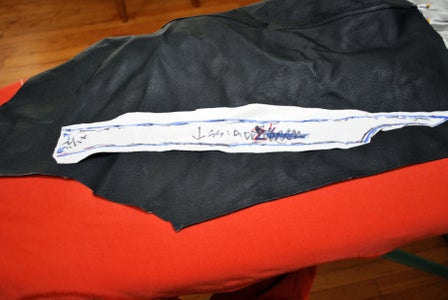

First up I found a scrap piece of leather (part of an old pair of pants) that was large enough to fit my pattern piece plus the added amounts noted on the pattern. In this case, I needed to add 2" to the side seam, 1/2" to the bottom edge and my standard 3/8" seam allowance to the inside edge, top and armhole.
I trimmed off the pattern piece along the clean new blue pen lines I drew in the last step and laid the piece down on the leather again, right side up. I measured out 2" from the side seam edge with a clear plastic ruler and marked my seam allowance with the blue pen. At the bottom, I measured 1/2" away from the edge with the ruler and marked it in pen, then added 3/8" to all the remaining seams and marked those as well. I joined the underarm seam with the side seam by lining the ruler up with the pen marks and filling in the line with the pen. Then I cut out the leather piece along the fresh new lines and laid it over the mannequin's left side seam to check the fit. It seemed all right, but it was too soon to tell.

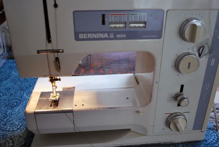

Piece #2 was processed the same way as piece #1. I trimmed the pattern off along the new blue lines, laid it out on an old green suede jacket sleeve, drew out the new seam allowances and cut out the leather. Then I took pieces #1 and 2 to my trusty Bernina 1020 sewing machine and set the stitch length to 2, which is a relatively short and sturdy stitch. I used a Teflon foot on the machine to sew all of Kali's leather pieces.
Pro tip: specialized machine feet can help speed up your sewing, but they aren't cheap. For most regular sewing, you only need a standard foot and maybe a zipper foot. If you do a lot of chiffon or satin hems, though, a roll hemmer is brilliant. A ruffling foot will make short work of gathering on miles of ruffles and an embroidery foot is great for embroidered details. There's a wide range of special feet for just about any task.
A Teflon foot makes sewing leather or vinyl a breeze because Teflon doesn't stick to the materials. (Regular metal feet will stick to vinyl and to some kinds of leather.) It's also nice for sewing velvet. But it's expensive, and if you don't sew these materials often you may not want to pay the extra bucks.Take a look online for to see what kind of feet are available for your sewing machine, and see if it's worth it to you.
I matched up the edges of pieces 1 and 2 and (starting from the bottom) lined both edges up with the edge of the Teflon machine foot. On most standard machine feet, including the Teflon foot, the distance between the foot edge and the needle is 1/4". It's a quick and easy way to measure a 1/4" seam allowance. I backstitched at the bottom, sewed up the seam and backstitched again at the top edge, then clipped my threads and took the pieces out of the machine. Then I trimmed off my seam allowance to a scant 1/8".
"Scant" is a sewing term for "just under", so a scant 1/8" is just under 1/8". I didn't measure the exact amount, but it would be somewhere in between 1/8" and 1/16". Maybe 3/32"?

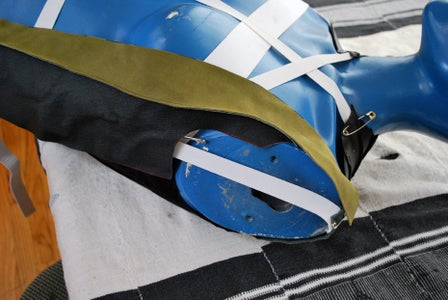

After trimming down the seam, I test fit the 2 pieces on the mannequin. They looked okay, so I moved on to piece #3.
