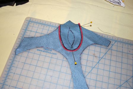

I cut the leather for Kali's forehead, nose bridge, and third eye base. The forehead and nose bridge had a 1/4" seam allowance added all the way around each edge. For the third eye base, though, I cut out right along the oval edges. I wanted to build it as a fully finished piece that could be shifted around easily. That meant the edge needed a finishing touch. I pulled out a narrow magenta zipper and held it to the edge of the oval to see how it looked. It was good, so I dug out one of my favorite Bernina machine feet and set the sewing machine to a short, tight zig-zag stitch.
Pro tip: specialty machine feet are sometimes worth the extra cost. It all depends on the kind of sewing you plan to do. Most of the time you don't need anything more than a standard foot that works with both a straight stitch and a zig-zag. When you really need a zipper foot, though, nothing else will do. They are great at getting right next to the edge of a zipper. They're designed to only work with a straight stitch, though, and I needed something more secure. The machine foot I chose let me get right up to the edge of the zipper teeth AND zig-zag at the same time. Excellent!
I sewed the zipper to the edge of the leather oval so that the zipper teeth and a tiny edge of the magenta backing fabric showed, but the rest of the backing stayed underneath the leather oval.Once it was sewed, I turned the oval over and tried to clip the fabric backing so it would stay nice and flat. This didn't work out so well, so I ended up trimming the backing down to a scant 1/4". That did the trick. I took the oval back to the machine, shortened the stitch length to just below the "1" marking and zig-zagged the edge again. The edge looked much cleaner with a solid black outline.
I put the oval on the forehead and pinned it a couple of times to keep it in place, turned the forehead piece over, and then used masking tape to hold the oval down. I turned the piece back over, took it to the sewing machine, and sewed the oval down. After clipping my threads, I pulled out the third eye pattern and test fitted it over the oval. It looked good, so I got ready to build the eye.

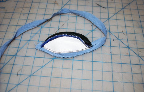

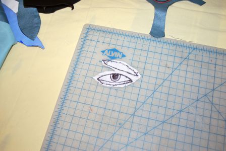

I unpinned the third eye pattern and laid it out on the cutting mat, and then chose my materials. I picked dark green for the upper eyelid, white leather for the eye, and two different zippers for the lashes (royal and baby blue).

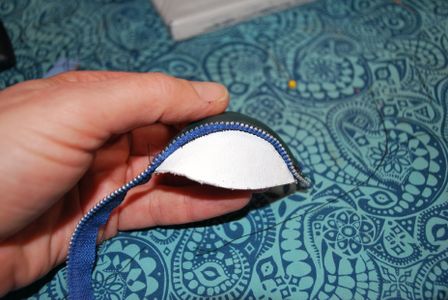

The top eyelid didn't need any seam allowance since I planned to finish off one edge with zipper "eyelashes" and the top would be zig-zagged down flat. After cutting out the lid, I moved on to the white of the eye. I added about a 1/4" seam allowance at the top and 1/8" at the bottom edge and cut the piece out of white jacket leather. The top zipper lashes went next. I zig-zag stitched the royal blue zipper to the bottom edge of the eyelid, curved the lid over the white of the eye, pinned it into place, and then stitched the lid to the white along the zig-zag stitching line. Once the zipper fabric was trimmed, the top lashes curled up nicely. I trimmed the extra zipper ends away and set up the lower lashes.
I pinned the baby blue zipper to the underside of the white eye base and straight-stitched it down. Unlike the top lash, I sewed the bottom lash so about 1/4" of zipper fabric extended past the edge of the white leather. After trimming the seam, I folded the zipper edge around to the front so it encased the bottom edge of the eye, and then stitched it downright next to the zipper teeth.
After picking out a glass terrarium rock to use for an eyeball I was ready to move on to the iris.

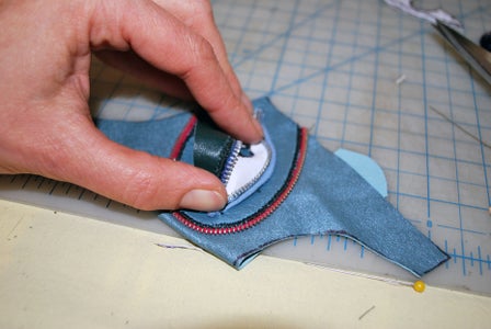

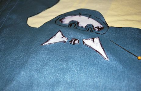

Before attaching Kali's third eye, I checked out the placement on her forehead. The eye was wider than the original pattern (the zipper lashes added almost 1/4" to each side), but it still fit inside the oval. I centered the eye, pinned it down, and zig-zag stitched the outside of the lower eyelid down.
I pulled the top of the eye aside and test fit the shaped piece of ethafoam rod underneath. I then got out Elmer's glue and some coffee stirring sticks, spread glue under the eye base, glued the foam in place, and let it dry for a few minutes. Once it was secure, I made a little hollow in the center of the foam to make room for the glass "eye". I put the glass into the hollow and checked the fit again. It seemed okay, but it looked like I could use a little more foam at the bottom to hold the glass securely and to fill out the eye.
I cut out a foam crescent, pinned it in place underneath the glass eye, pulled the eye leather over the foam and glass and pinned the edges down to the forehead. After that, I sewed the top edge of the eyelid down with a short, tight zig-zag. That took a few tries, but it got sewn eventually, and all the innards stayed in place.
Pro tip: plain white glue may be associated with grade school craft projects, but it is a great, non-toxic choice. It's not as secure as contact cement or epoxy. It's also not going to eat your skin away, give you a vicious headache, or cause brain damage. Wherever possible, I prefer to use non-toxic solutions! At any rate, if you both glue AND sew, your work is probably going to hold up pretty well. Glue alone can't guarantee durability, no matter how good it is.

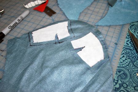

Step 7: Lower Eye Base

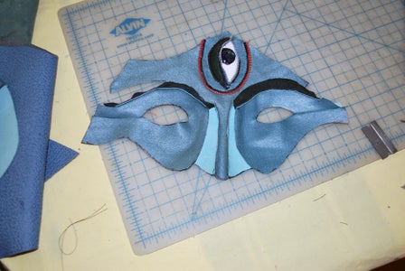

One eye down, two to go! I removed the patterns for the lower two eyes, eyelids, and surrounding areas, and laid the pieces out on the cutting mat. They were different shapes, but not by too much. I chose materials for each area: white jacket leather for the whites of the eyes, baby blue upper lids, and silvery blue jacket eye surrounds. After that, I cleaned up the pattern lines, trimmed the pieces and laid them out onto their respective leathers.
The eyelids had a 1/4" seam allowance added on top and at the edges, but no seam allowance on the bottom. Those edges would get finished off with zipper teeth. I added 1/4" seam allowances all the way around the whites of the eyes and the eye surround pieces. Once the pieces were all cut out, I marked the iris placement on the whites of the eyes. I laid the pieces on the mat and removed the patterns for the sides of the nose from the mannequin.
I cleaned up the patterns, trimmed along the lines and cut the nose sides out of a pebbly blue leather with a 1/4" seam allowance added all the way around. I set those aside, took out the eyebrows, and sewed them to the top of the eye surrounds with a straight stitch and a 1/4" seam allowance. I trimmed the seams down to a scant 1/8" and laid them out on the mat. After unpinning the forehead and third eye from the mannequin, I put in between the eye surrounds and placed the nose sides down on the mat to see how it all looked together.
I really didn't like the sides of the nose. The pebbly blue and the silvery blue looked unpleasant together. The suede side of the silvery blue looked great, though. So I re-cut the sides of the nose in that suede and sewed them to the sides of the nose bridge. Much better!

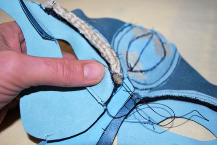

I took the upper face back to the cutting mat to figure out my next step. The left side of the forehead was buckling a little, so I decided to trim out the old forehead from the back side. That made it much smoother. I then found scrap yarn and cording to use for padding and took out the needle and heavy duty thread.
The left eyebrow didn't need much padding. I found a chunk of cording that filled the space nicely from the back and smoothed it into place. I then whip stitched the cord to the top seam allowance. Since the bottom part of the eyebrow was sewn with the seam allowance on the outside, I couldn't whip stitch the cording down without it showing through, so I did a hem stitch instead. Since all the materials I used were black, it was almost invisible. That was great for Kali but made it very hard for me to take a good picture! I used a much thicker beige yarn for the right eyebrow, which filled it out nicely and was much easier to photograph.
I cut the yarn so it was a little longer than the eyebrow area and sewed around each end several times with the heavy duty thread. The yarn unraveled quickly, and wrapping thread around the ends kept it from falling apart. I put the yarn in place and whip stitched the top seam allowance over the yarn. At the bottom edge, I sewed the yarn to the eyebrow using a hem stitch. This meant I took big "bites" of the yarn with the thread, but very small "bites" of the suede right above the seam. Since the suede was fuzzy, the texture helped disguise the stitches. They were nearly invisible from the outside.
I checked the eyebrows from the front. They looked good, so I turned the face back over and started putting the nose sides together again. I sewed the inside corners of the eyebrows first and clipped the seams. After taking little darts in at the corner of each eye to make them indent a little more, I sewed the sides of the nose to the eye surrounds again. I trimmed the seams down to a scant 1/8" and taped the seams open from the inside. Since those seams were sewn twice, they needed a little reinforcement.

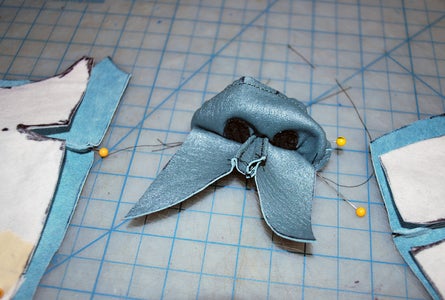

I cleaned up the lines and cut the patterns out, and then got out the silvery blue leather for the nose base and upper lip. The nose base was simple. I drew that out with a 1/4" seam allowance all the way around and marked the nostrils. For the upper lip pattern, I added a generous 1/8" in between each line. The plan was to sew in tiny tucks at each line to help shape the upper lip. I marked the top and bottom of each of those lines, taped the pattern together with the added 1/8" in between each line, and double checked it against what I'd drawn on the leather.
Well, that didn't work at all. One of those pieces shifted while I was drawing them out, and the leather was way off. So I crossed out the lines, moved on to another part of the leather, and re-drew the upper lip using the taped pattern. Much better!
After cutting out both the nose base and the upper lip, I sewed in the little tucks on the upper lip. I sewed the center tuck from the suede side and the other two tucks from the smooth side of the leather. That did a nice job of creating a shapely upper lip.

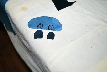

After checking out my own nostrils I was ready to start building Kali's. I cut little nostril shapes from black suede that were about 1/8" bigger than the marked nostril areas and very carefully sewed gathering stitches around the top edges. I then pulled on the bobbin threads to ease the nostrils in, zig-zagged the edges down at the marked lines, turned the nose base over, and trimmed the blue leather just inside the zig-zagged stitching lines. That made it possible to pop the nostrils inwards.
Eventually, those nostrils will get glued or sewn so that they stay indented.
I cut the cheeks out of baby blue suede, adding 1/4" seam allowance all the way around each piece. After that, I pinned the nose base to the upper lip from the inside, checked the fit on the outside, and then sewed them together with a straight stitch. I had to ease the upper lip a little bit to get it to fit, but it looked pretty good. Once the seam was trimmed down, I sewed the cheek darts, trimmed the seams, and checked to see how the cheeks fit the sides of the upper lip.

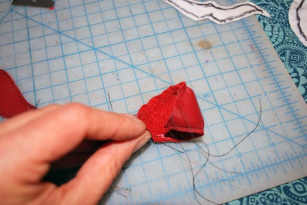

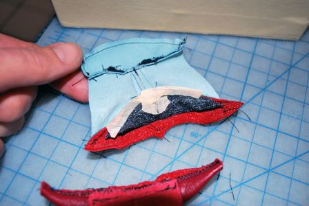

I unpinned the tongue patterns and laid out the pieces on scraps of a red leather jacket, using the suede side for the top of the tongue and smooth leather for the bottom. I added 1/4" all the way around the top of the tongue and marked the center lines. After setting the sewing machine to a straight stitch, I sewed a tiny tuck along the center line of the tongue's top from the back side. I then positioned the tuck over the groove in the foam tongue. I pinned the leather down, turned the tongue over, and put masking tape over the center line of the foam. That protected the foam from shredding as I sewed all the way through the suede and foam.
Once the top was secure, I pinned the underside of the tongue to the top around the edges and straight stitched the top and bottom together. I sewed this edge from the bottom side, pulling the leather a little as I sewed so that the slightly larger top edge would ease into the smaller bottom edge. After trimming the seam allowances down to a scant 1/8", I turned the tongue to the bottom side again and sewed the bases together.
Pro tip: use feed dogs to your advantage! Feed dogs are the little metal teeth you see on a sewing machine, right underneath the machine foot, and they help drag your material along as you sew. They also have a tendency to ease the bottom edge of your material in a little bit more than the top. This can be very helpful. If you have a piece of material that you want to ease in slightly, sew from the opposite (or shorter) side and pull on the shorter side while you sew. The bottom side will naturally ease in. This is great when you want to create curves or add a little extra room, like when you're fitting the top of a sleeve into an armhole.
