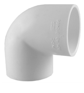

QTY (2) ½” PVC Elbow

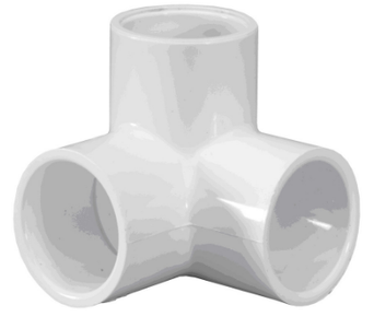

QTY (2) ½” PVC 90 degree Tee

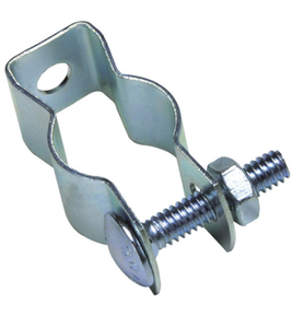

QTY (2) ½” Conduit Hangers
QTY (2) ¼”-20 Wingnut

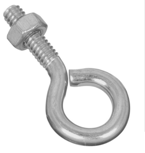

QTY (4) 3/16” x 2” Eye Bolts

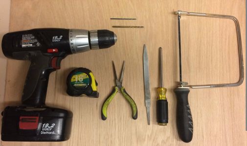

Step 2: Tools
Drill with size 1/8” & 3/16” bits
Saw (I used a coping saw but you can use just about any type)
Philips Screwdriver
File or grinder/ Dremel
Needle Nose Pliers
Vice (optional, helps when drilling hole in the caps and elbows)
Sewing Machine (optional, but recommended)

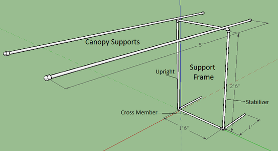

The PVC Frame consist of 2 major parts: The Canopy Supports (consisting of 2 supports) & The Support Frame (consisting of 2 Uprights, 2 Cross Members, and 2 Stabilizers)
Note: Dimensions shown are for the cut PVC lengths only. Each PVC Elbow adds ½” in each direction so overall dimensions are 1” greater than shown in picture
Step 4: ​Cut the PVC
Use a saw to cut the (2) 10’ pieces of PVC as follows, use (1) piece for the Canopy Supports and (1) piece for the Support Frame:
QTY (2) Canopy Supports @ 60”
QTY (2) Uprights @ 30” This dimension can vary on your height and type of kayak. A sit-on-top kayak may need taller uprights as would some one with a relatively tall upper body. To check, sit in your kayak as you normally would and have someone measure from the top of your kayak to the top of your head and add 2-4”.
QTY (2) Cross Members @ 18” QTY (2) Stabilizers @ 12” These can be longer or maybe slightly shorter, it just happened to be what I had left over after cutting the uprights and cross members

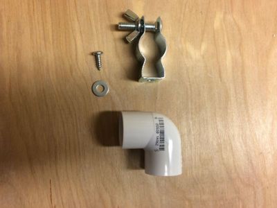

Step 5: ​Canopy Holder
Find and Mark the Top of the PVC Elbows and Drill out using 1/8” drill bit
Attach the Conduit Hanger onto the elbow by using a #8 screw and washer
Repeat for the 2nd holder

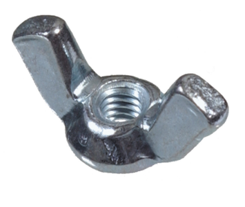

Remove the hex nut from each Conduit Hangers and replace with a ¼”-20 wingnut. This will make assembly and disassembly tool free.
Round the edges of the Conduit Hangers with a file, a bench grinder, or a Dremel like tool. This will keep the canopy from catching or tearing on the edges of the Conduit Hangers
Step 6: Caps & Tie Downs
On each PVC cap Find and mark top center (or as close as you can get)
Drill hole using 3/16” drill bit
Screw in the Eye bolt and tighten the nut on the inside of the cap with the needle nose pliers
Install Caps/Tie Down on both ends of the Canopy Supports

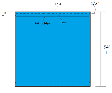

Step 9: Fabric Canopy Hemming
Hem all four sides as follows:
Take one end of W and create a 1” fold. Pin and repeat with the opposite side
Sew a ½” hem on the two folded/pinned edges
Follow the same procedure for L
These hemmed edges will help keep the fabric from fraying

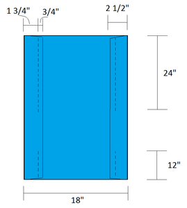

Step 10: Fabric Canopy Pockets
Measure and fold one of the W sides to 2 ½” and pin.
Repeat with the opposite side.
Insert the Canopy Supports (with the caps on) into the pinned pockets to be sure they fit. Install onto the Support Frame to be sure the Canopy is not too loose or too tight. Make adjustments if needed.
Sew both pockets as shown in the pics: Sew about 24” down one end of the pocket and move to the edge and sew 12” down from the other end*
*This will make it so the Canopy can be installed on the Canopy Support while it is already installed on the Support Frame. It will also allow the Canopy Support to be adjusted forward and backward on the Support Frame.

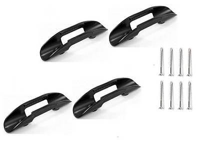

I happen to have a storage hatch with bungee cord strap downs on the stern of my kayak that I was able to use to mount the Support Frame.

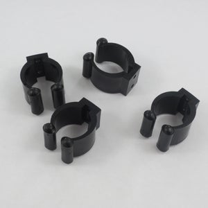

You can also use paddle clips or something like the above pics
if all else fails you could wrap a bungee cord around the hull of the kayak and slip the stabilizers under it
