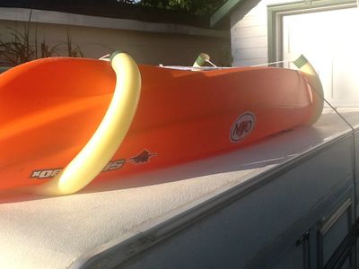

Step 12: EXTRA BONUS - Even Cheaper Kayak Rack.
This kayak is nice a square on the top side.
A couple pool noddles and some rope is all you need.
I threaded the rope through the noodle and made a complete loop.
Then I tired the two loops together so that they would not slip away.
Then I tied down the kayak with ratchet straps.
I always do one on each end and one across the middle. Double redundancy will save you.
