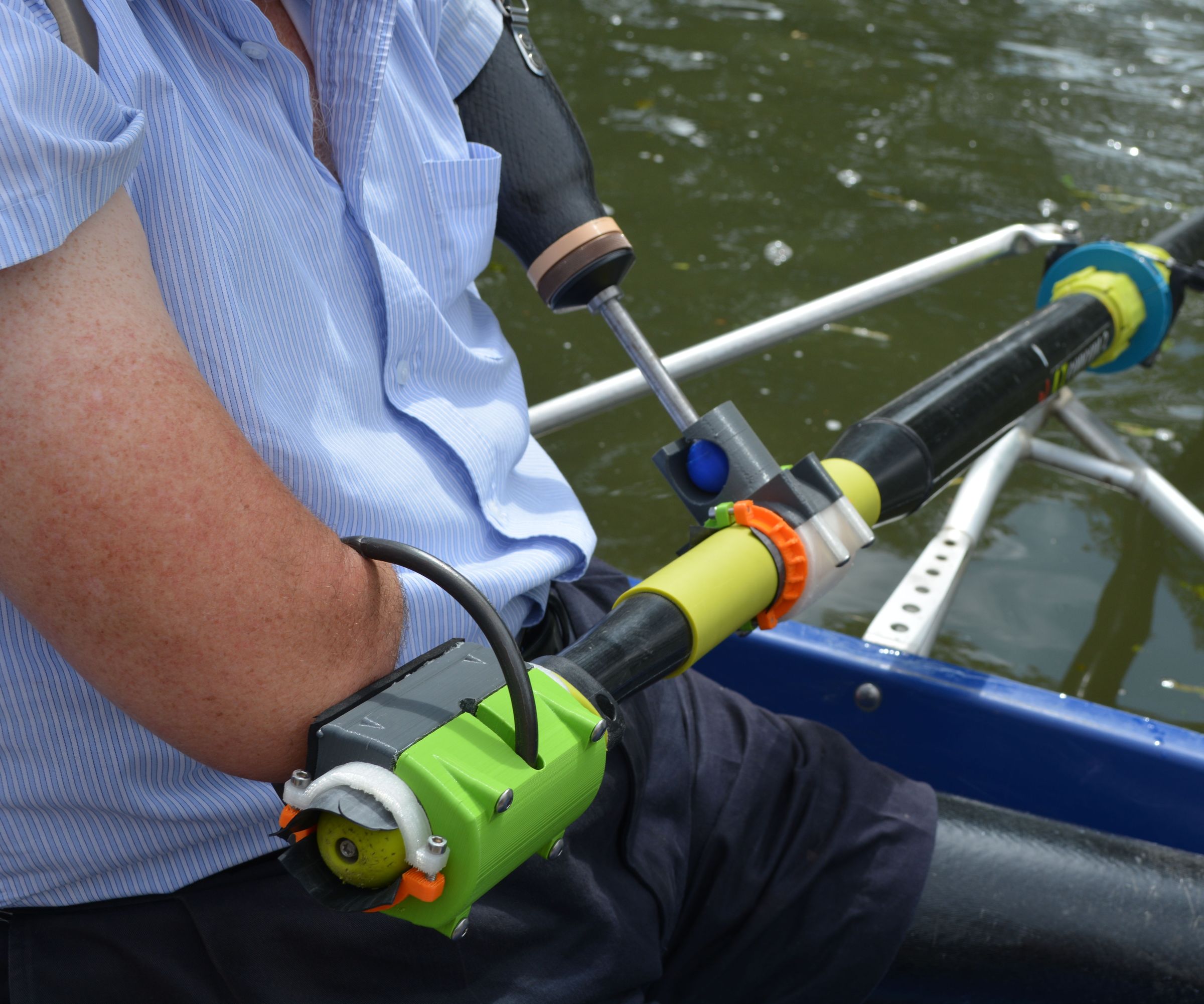

This Instructable is made up of two separate devices ('Paddle Ball' and 'Paddle Hoop') that can be mixed and matched depending on your amputation level. Please refer to the table to identify what you will need.
NOTE: If you have a unilateral transhumeral amputation you may find it easier to use a short metal rod in combination with a paddle hoop that you put your remaining arm in.

Step 13: Paddle Hoop Full Assembly and Use
• To use, slide your residual limb into the space between the hoop an the arm curve.
• If you find the space to fit your arm in too tight/loose then the hoop can be replaced with a wide range of hoop diameters (also available from www.fhbrundle.co.uk). Alternatively the foam padding size can be increased.

Step 24: Paddle Ball Full Assembly and Use
• To assemble:
– Screw the metal rod into your socket.
• The ball on the metal rod is designed to click in and out of the housing component.
