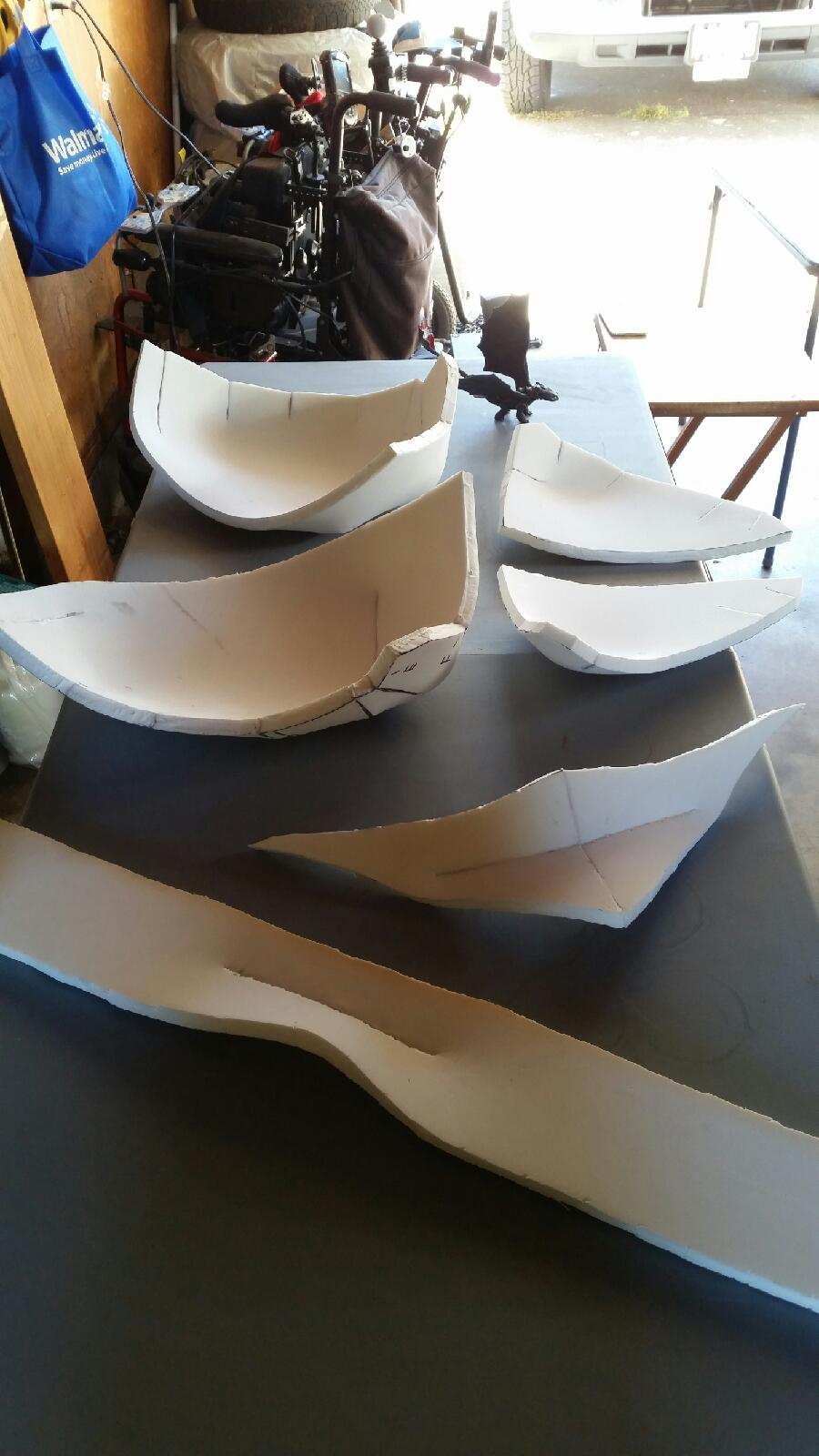

Step 1: Carving Out a 3d Sculpt for Making Patterns
First you start out creating a scaled sculpt for creating patterns. Our sculpt here was carved out of a block upholstery foam. You get your patterns by laying fabric over your sculpt creating folds aka darts in the fabric so it lays flat on your sculpt. Similar to what seamstresses do in sewing patterns. Carving was done with carving knife, razor blades and a dremel sanding pad. Next cut out the patterns and glue. We used L200, a closed cell foam. Glue with contact cement and BAAAM!!! An Indominus head, well the start of one!
The Toothless Instructable goes into more details on this same technique working with foam, patterning etc. Check that out if you need more detailed instruction or send me a message!
