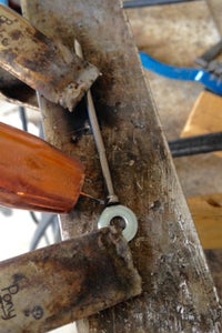

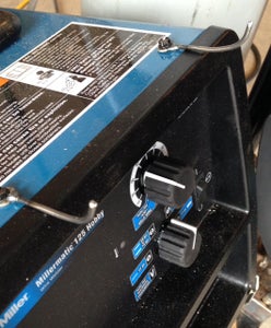

The top of my welder has two hex head screws to hold the outer skin of the welder in place. See the first photo. I will utilize those screws to suspend a Plexiglas cover over the wire speed adjustment knob. See the second photo. I welded a #8 flat washer to the head of a 2 inch finish nail and ground the weld reasonably flat. I also ground the point of each nail smooth and round. I removed the hex head screws and screwed the nail/washer pieces in place. I bent the ends of the nails upward in an arc with a pair of pliers.

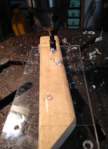

Step 2: Cut Plexiglas and Drill
I cut a piece of scrap Plexiglas in the form of a rectangle to hang on the curved nails and cover the wire speed knob. I marked and drilled holes for the nails and for screws that will hold standoffs in place.

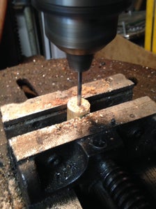

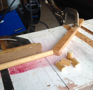

Step 3: Cut Dowel Standoffs and Drill
I used a stop on a table saw to cut uniform dowel standoffs. I drilled a hole in the end of each for a #8 screw.

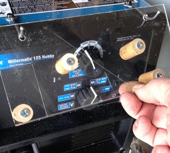

I screwed the wood standoffs to the Plexiglas and slipped the Plexiglas over the nail hooks. It hangs flat without resting on the wire feed adjustment knob.

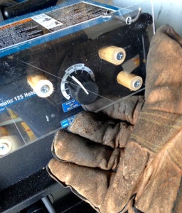

I can easily slip a gloved finger under the Plexiglas and adjust the knob as needed. I can easily see the settings scale and knob position indicator. But, it is now nearly impossible to bump the setting on the wire speed knob unintentionally.
See the second photo. If need be, I can lift the Plexiglas and remove it.
