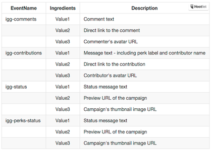

Step 10: Format How Information Will Be Added to Your Channel
In this table, you can find what each value {Value1, Value2, Value3} corresponds under each Indiegogo event. By re-arranging and adding text before and after these values, you can format how information will be presented to you in your selected output app (in this case Evernote).
