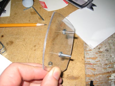

Step 4: Create the Brackets
First of all you'll need a way to attach the plaques to your taps. I picked up a four pack of two and half inch corner braces from Home Depot (Stanley 30-3490), but any hardware store should carry something similar.
The location of the holes as manufactured wasn't right for the distance I needed the plaque to be from the tap handle. As a result, an additional hole was needed. As luck would have it I found that drilling a new hole directly between the two existing holes (on top of the word Stanley for me) was pretty much exactly where I wanted it.
Since the hole has to fit over the existing tap screws you may want to gradually expand it until you find the right size. Unfortunately I don't remember the exact size of the bit I ended on.
After the hole was drilled, I used a hacksaw to remove the back of the bracket, no sense in having a bit of metal bulging out the back of the tap. For those with smaller tap handles, you may need to cut in even closer, and possibly use a grinder to give it a nice rounded edge. In my case however it all disapears under the handle, so I took the lazy route.

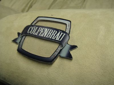

Step 5: Create the Logo
Original concept
In our case we took great care to identify the generic iconography that constitutes a typical beer logo. A quick google image search showed us the following are the main elements that will give you that beery look:
- A sylized beer barrel
- Wheat Sheafs
- A wavy banner
- A star or a crown (or both)
- Pompous looking latin text
- Coin or coins
Beer Plaque treatment of logo
The concept drawing wasn't entirely transferable to the plaque execution, so we had to do some redesigning. You'll see that for the final design we decided to remove some of the elements and reuse some of the elements so that they would be easier to render in Lexan.
You may want to create your own plaque design, however if you want to reuse our template feel free. The source Photoshop document (PSD) file is included and you can use for non-commercial purposes (remix, share-alike yada yada). You may also find this file useful to dissect and see how we set up the layers. The layers in the files were separated and set up with bleeds before printing to the translucent film.
If you attempt your own plaque you probably should have some clue about how to wield Photoshop (or any other layers based image editing program). The finer points of the logo creation are probably outside the scope of this Instructable.

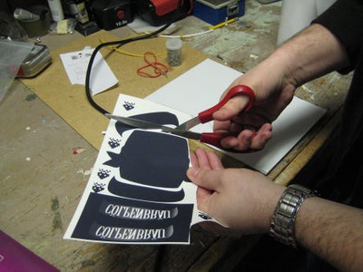

Step 6: Create Jigs
We created jigs to help us cut out the shapes from the Lexan sheets. The jigs we made are essentially outlines created from the master Photoshop template that you use to cut away negative space from the intended shape. Jigs can be created on any adhesive backed paper you can put through your printer then affixed to the Lexan board you'll be working with. We used the expensive clear labels (because we determined the opportunity cost of going out to find cheaper alternatives would outweigh the cost of using the expensive clear film).
We created the following jigs (one for each lexan layer):
- Barrel shape, no frills (aka back plate Step 13)
- Barrel with frills
- top furl of wavy banner
Have a look at the video to see how we created our jigs from the source file.
(as mentioned before, we assume you know a little about Photoshop)

Step 8: Cut the Lexan
Now it's time to actually cut the shapes out of the lexan. We used a variety of techniques to get down to the exact shape we were looking for. I'll try to describe these techniques as well as I can, but you should check out the images below for a better understanding.
Roughing
To start out with we just want to get a very broad cut around the shape. This way you won't have the entire sheet of lexan cluttering your space.
Cutting closer
Now that we have a more manageable piece to work with we use the small rotary tool bits to slowly cut around the shape as close as possible. But remember, just as in kindergarten it's important not to cut inside the lines.
We found that it worked well to move a couple of centimeters forward, and then run the bit back over your work. The rotary tool has a tendency to melt the lexan, so the spot you just cut can end up sealed back up. The back a forth cutting should help clean this out.
Pay particular attention when in tight corners, like around the banner. You're not going to be able to do as much work in the "grinding down" phase in these tight spots.
Grinding down
By this point you should have a shape cut out that makes a reasonable approximation of your desired final shape. Now we'll use a grinding bit on the rotary tool to get down very precisely to the outline.
We found it worked best at this stage to hold the rotary tool stationary in the clamp, and move around the shape itself.
Buffing
Next we used a series of attachments in order to buff the edge down to as smooth a line as possible. We probably went a bit overboard with all of the attachments we used, and I can't even begin to list all of the ones we tried.
A good idea would be to take a small piece of scrap lexan (perhaps the excess created during the "Cutting Closer" stage) and try out a few techniques until you find a combination you like.
If you check out the pictures below you should see shots of all the bits we settled on.
Box cutting
Once we'd buffed the edges down, we removed the protective paper from the lexan sheet. At this stage you may see some excess material around the edge that was obscured by the paper. We used a box cutter to remove this excess material.
In some cases we found it useful to do a bit more buffing after the excess and paper were removed. You'll probably know from a simple visual inspection whether this is necessary.

Step 9: Create Backing Images on Transparent Labels
Using the logo source file from step 5 (or your own designs) split up the layers. The following video is a conceptual overview of how we split up the layers and prepared the artwork and bleed for print. For more detailed instruction on how to manipulate layers in Photoshop consult the interwebs.

Step 13: Create the Back Plate
Taking the back piece of lexan (the barrel with no frills) we place the L-bracket in the desired final location. Use a pencil to mark off the spots where the holes should go.
Using the drill press (or failing that, a hand drill and a steady hand) place a hole at the two locations that were marked off.
Next we want to bevel the holes, so that the bolt sinks down in the Lexan rather than protruding. Use a counter sink bit to create a nice beveled indent that the bolt can sink into. We're going to be placing the vinyl over the head of the bolt, so try and get it as level as possible. Remember, you can always drill a little more if it's not deep enough, but you can't undrill.
Once the bolts are in place you can attach a nut on there. It will act as a standoff to keep the plaque from being pressed right up against the bracket.
Finally we're going to apply some of the vinyl backing to the back plate. The vinyl will be placed on the front of the plate which will give you a nice white background for the rest of the plaque to work against, as well as conceal the heads of the bolts. the vinyl also prevents the removable insert card from getting caught up on the heads of the bolts when you are swapping brands.
Step 14: Assembly
Now the only thing left to do is assemble the pieces.
On the backing plate, using the double sided tape, create a "cup" or a ledge around the bottom half. In addition to attaching the above assembly to the backing plate, this ledge is what will cradle the removable insert card when the assembly is complete. The thickness of the foam tape provides more than enough clearance to accommodate a 100lb card stock.
Sandwich together the layer-1-and-2 sub assembly (from step 12) and the back plate to form the completed assembly.

Step 16: The Finished Product
And that's it! When you're finished you should have some rather fetching taps to advertise your current beer selection, whatever it may be.
