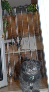

Need a barrier between cats and dogs or other pets?
Something as movable as a fold-up kennel?

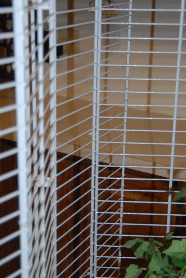

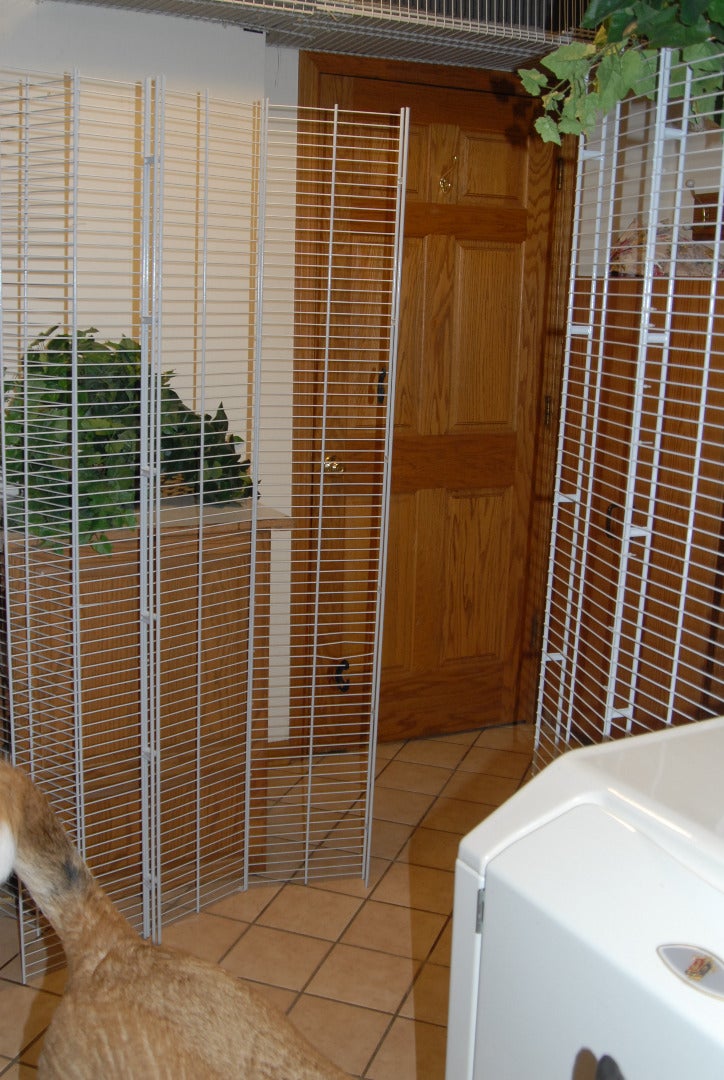

This could be an answer. After obtaining several 6 feet lengths of shelving I cable tied them in a zig zag fashion, and lived with the structure for several weeks.
Egged on by my favorite INSTRUCTABLES SITE, I finished it tonight.
My dogs and cats supervised. As in all photos, I think there is more interest with humans or pets attached.

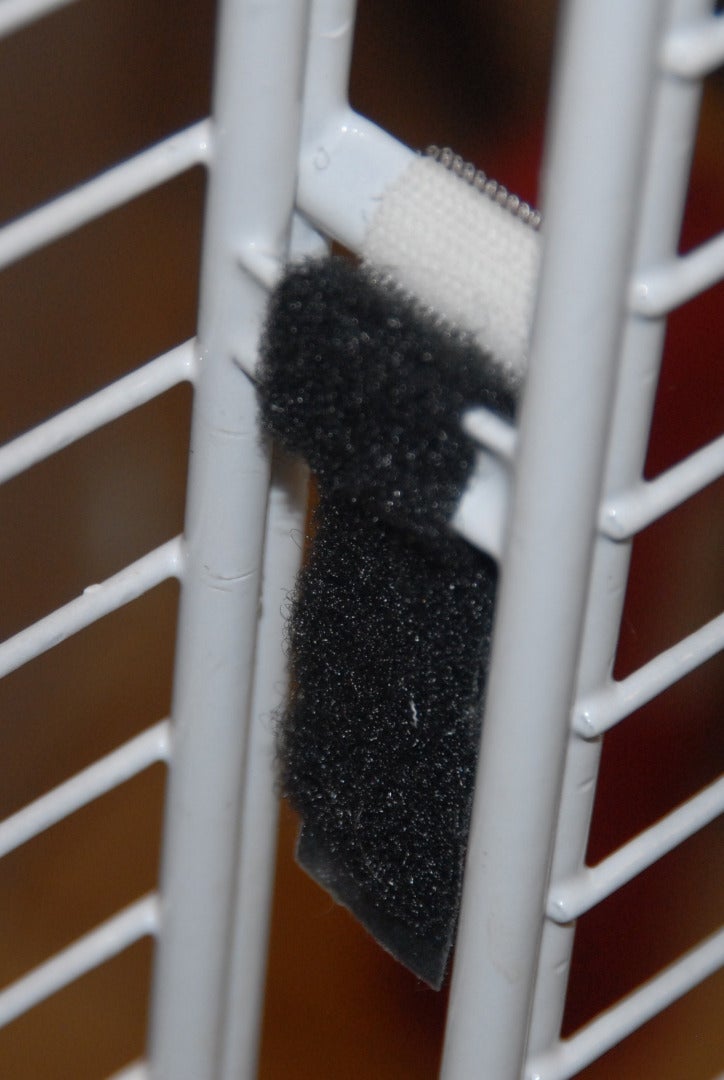

Velcro for quick latching

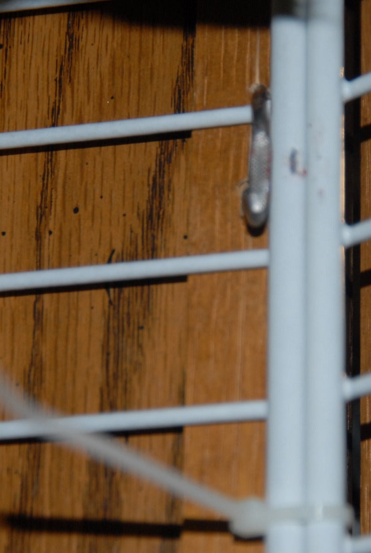

Roofing staples
to secure shelving to wood

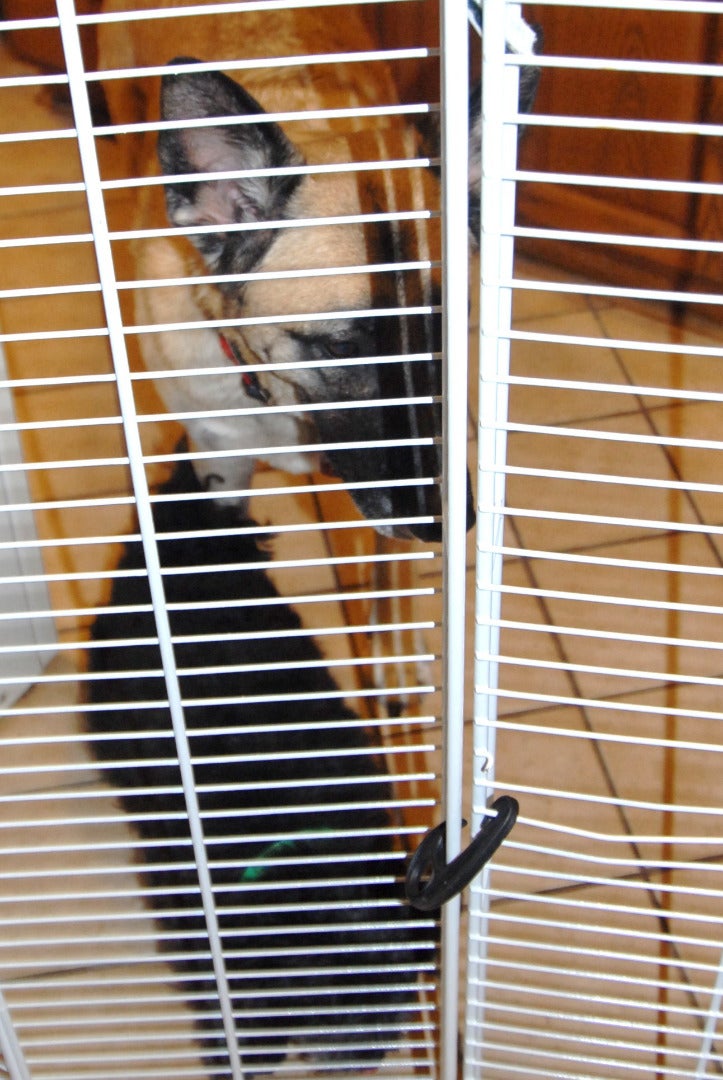

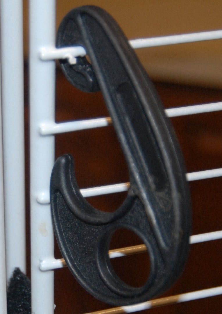

Clip
for latching, that can be reached from either side.
I had thought about making two doors, one arching in and one arching out (fool strangers), but with this short length it seemed unnecessary.
With two entrances, you could keep the clip on the outside of each. Many times I find I have misplaced the clip, so Velcro is nice in this instance.

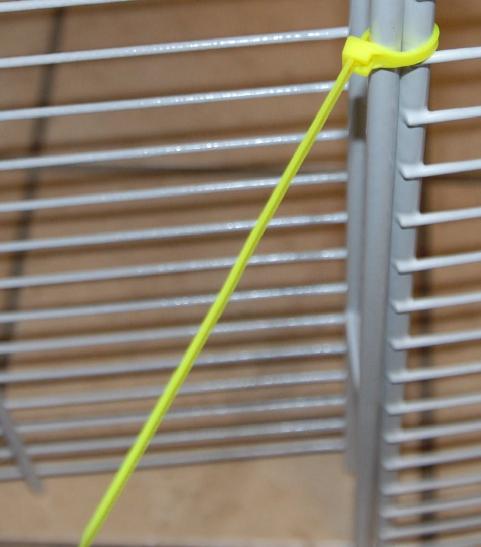

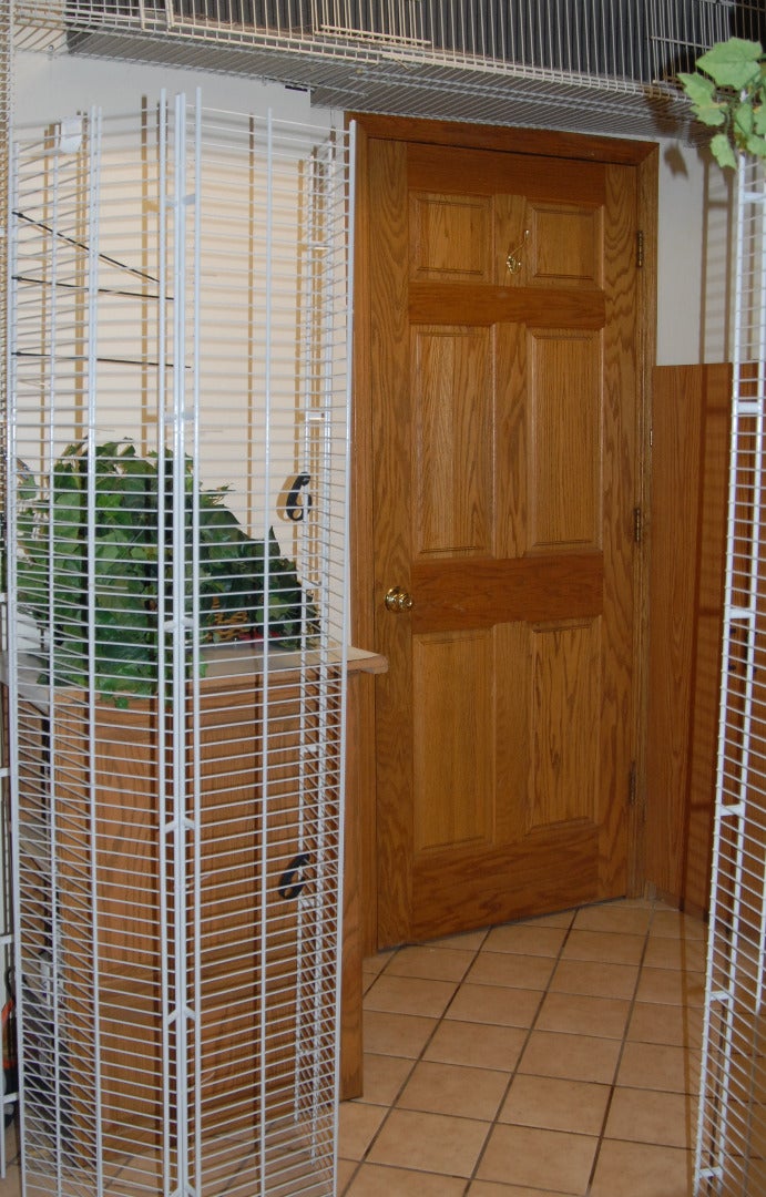

Step 3: Measure, Plan Arrangement, Start on One End.
See photos for reinforcement and latching options.
Hover mouse over squares for further comments.

Cats can _climb_ fencing like this, however it has not been a problem here, because most are too heavy and it's unstable for serous climbing.
Another reason this has worked (there have been a few minor escapes)... is there are dogs on the other side...so the cats have little reason to escape into the clever, heavy paws of the dogs.
Also, with using Velcro and loose clips, if there were a fire or emergency, with determination they could escape and perhaps survive a disaster.
Also, I can move it, as it is flexible or it could be down in minutes.
I leave slack in the cable ties when I can, so they are not difficult to cut.

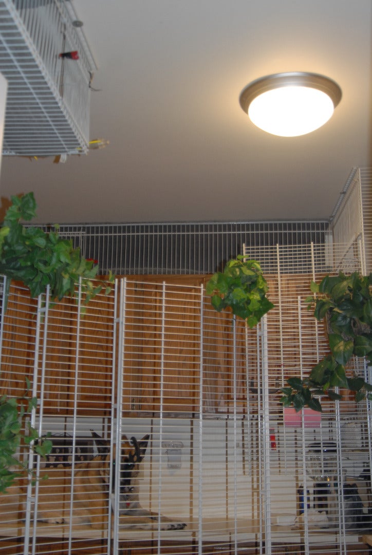

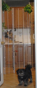

Step 6: Full Length Kennel to Ceiling
We have made porch kennels outside with shelving.
One way to reach to the ceiling and make it escape-proof, would be to bend the tops (over a hard surface like wood), arching along the ceiling so for instance, cats could not escape.
