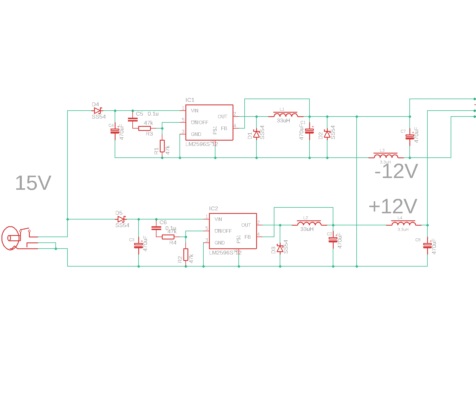

By schematics diagram you can see there are three main parts Microcontroller (connected as Arduino mini Pro), MAX3232 and ULN2803.
The MAX3232 we need to communicate with Kenwood transceiver by COM connector. The MAX3232 is capable of converting voltage levels seamlessly, so devices that operate at different voltage levels (Kenwood vs microcontroller) can communicate seamlessly with each other. It supports bidirectional conversion between RS232 voltage levels (+5V to +15V) and TTL/CMOS logic levels (0V to 5V or 3.3V).
The microcontroller sends a query (IF command) and analyzes the received data to determine the frequency at which the transceiver is operating. Based on the frequency, it determines in which band the transceiver is operating and activates the corresponding output pin.
The ULN2803 is a transistor array strong enough you to control common used relay coil of an antenna switch.
(Schematic digram is now corrected and is published as it works. Even if simplified schematics of ULN2803 shows comparator (or amplifier) on its input I realize the ULN2803 has quite low impedance so I had to add resistor R7 2k2 and to change value of R1 to 510ohm. (because inner pull-up resistor will not work :-) see 2803 inner schematics )
