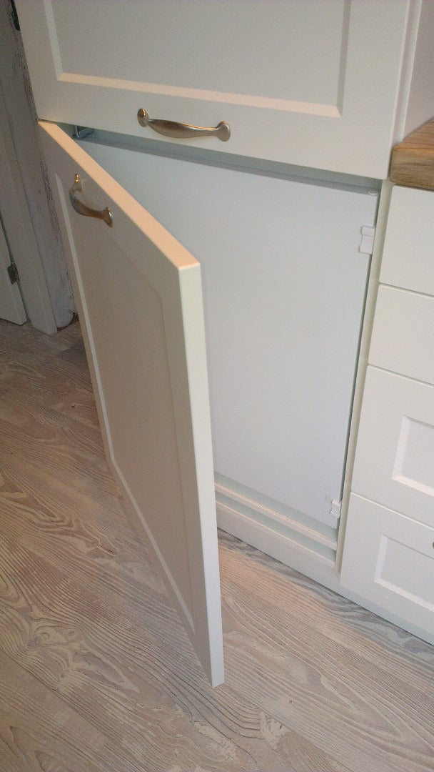

To open the freezer I had to mount two plastic rails against the wooden panel, which will pull open the freezer.
It was pretty hard to measure the exact location, where the rails had to be mounted. So I thought: “Ketchup!”

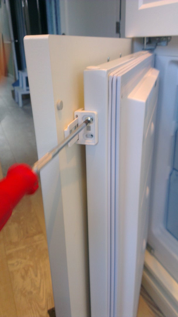

Step 2: Putting Togheter the Rail
Mount the bracket against the freezer. Slide the rail in position.
Hold everything in position and get on with your ketchup (the very best: Zaanse).
Put a small amount of ketchup on both sides of the hole.

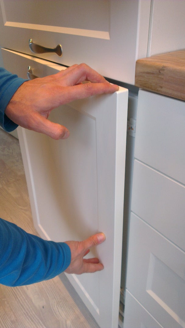

Step 3: Marking the Wooden Panel
Push the wooden panel against the marked rails. The ketchup will leave tracks on the wooden panel.

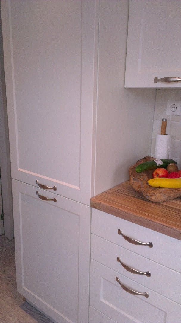

Some drilling (I didn't drill), cleaning, measuring, marking and it's done.
