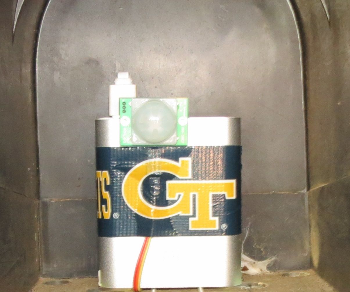

A Keurig coffee maker controlled by an Node Mcu ESP 8266 , Cayenne myDevices, Arduino Pro Mini and a stepper motor with driver.In essence, a hot cup of coffee made at 7:00 each morning.
Step 1: Code
Upload coffee starter to your ESP and Coffee press to your Arduino.
Step 2: Connect Up the ESP 8266
Connect Pin D2 from the Node Mcu Esp8266 to Pin 2 on your Arduino.
Step 3: Connect Up Your Arduio
Connect pins 5,6,10,11 to your stepper driver board.
Step 4: Screw on the Stepper Motor
Use self-taping screws to attach your stepper motor.
Step 5: Glue on an Extender
Use super glue and a popsicle stick to extend the stepper motor shaft. (I used a piece of a broken propeller)
Step 6: Set Up an Event on Cayenne MyDevices
Go to the top right of Cayenne and add an event for your morning coffee!
