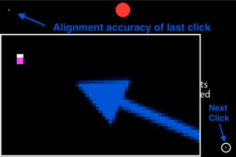

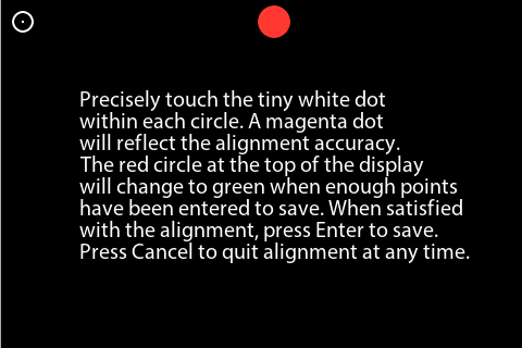

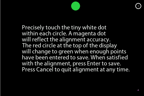

Before the touch panel can be used it must be aligned the first time it's used. There are two buttons on the CNC board labeled Enter and Cancel. Pressing the Enter button will display the display alignment screen as shown below.
Follow the displayed instructions. Keep selecting the white dot within the circle till the magenta dot covers or nearly covers the white dot.
As noted in the instructions within the screenshot, you keep selecting the white dot within the white circle till the accuracy is acceptable. Acceptable is defined as the magenta dots completely or mostly covering the associated white dots. You then press the Enter button on the CNC board to save the alignment parameters to the EEPROM. All preferences, such as the alignment parameters and setup settings described next are stored on a 24C64 EEPROM.

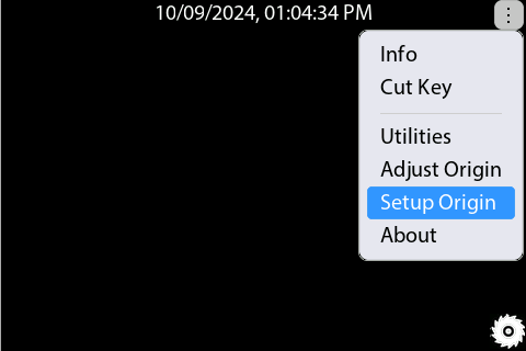

The Main Menu
Note that all of these screenshots were made using my Mac OS ArduinoDisplayTester app.
Setting The Origin

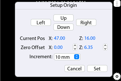

Before cutting a key for the first time, the origin must be defined. The origin defines the bottom left corner of the key holder. This operation should only have to be performed once for the life of the machine. The origin defined here will work for all keys from any manufacturer. There is no need to perform this operation when using a different key blank.
Using a micrometer, measure and save the width of a key blank blade in mm. Mount this key blank in the key holder.
From the main menu, select Setup Origin.
When you select Setup Origin the X and Z steppers are homed. The carriage will move below the cutter, and the cutter head will move to approximately 10mm above the expected location of the key holder.
Using the stepper button and the increment popup, enter the width of your key blank in the Zero Offset Z field. In the above example it's 6.35mm. The Zero Offset X field should generally always be left as 0.00.
The goal is to move the cutter so that it just barely touches the key blank shoulder and the top edge of the key blank. You move the cutter head using the Left, Right, Up and Down buttons. The amount the cutter head will move for each press is determined by the Increment popup. The increment is one of 10, 1, 0.1 and 0.01mm. You do not want to drive the cutter head into the key blank, so use the smaller increments.
Once you've positioned the cutter head so that it just barely touches the key blank shoulder and the top edge of the key blade, press Set. This will save the defined origin to EEPROM. The cutter head will rise out of the way and the carriage will move out from under the cutter head.
