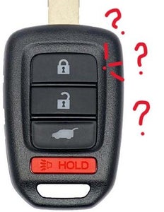

Does your car lock or unlock at seemingly random times? Have you needed to replace your fob battery, only to have it run out just a little while later? Have you found your car unlocked when you thought for sure it was locked?
It could be the key fob. More specifically, it could be the switches in the key fob being activated when you do not expect it. Mine was doing that, and it was a headache until I employed this fix.
I discovered it was very easy to activate the lock and unlock buttons on my key fob - even a light brush over the lock button would trip the switch underneath, and the unlock button was only a little bit better. It became so bad that I would keep the key in a separate pocket, and I would check the car whenever it rained to make sure the windows were still rolled up (thanks, Honda).
In this Instructable, I will show you how to make the unlock button a little less sensitive by filing down the button plunger. This will help make the button function as intended without changing the exterior of the fob or adding anything to it.

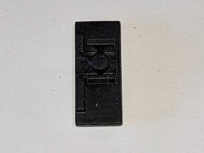

Step 5: Measure the Plunger's Original Height
The "plunger" is the cylindrical feature between the snaps. It is the feature that actually pushes the switch on the circuit board.
Measure the plunger height and write it down. You can do this using calipers (as shown) or a ruler, but either way, you need to know what the original plunger height is so that you only remove a small amount of material.
Do not skip this step. It is too easy to accidentally take off too much material and render the button useless.
In my case, the original plunger height is 4.2 mm (0.165"), inclusive of the entire button.

File the top of the plunger using the small flat file using steady, even strokes. Keep the strokes parallel to the plunger face as much as possible. You may want to turn the button around so that you're filing evenly from both sides.
Be sure to only file the plunger - the snaps need to stay intact.
Step 7: Measure the Plunger's New Height
It will not take long to file the plunger, so be sure examine your work and measure the new height frequently between filings. I only removed 0.37mm (0.015"), which worked well when I tested the button.
