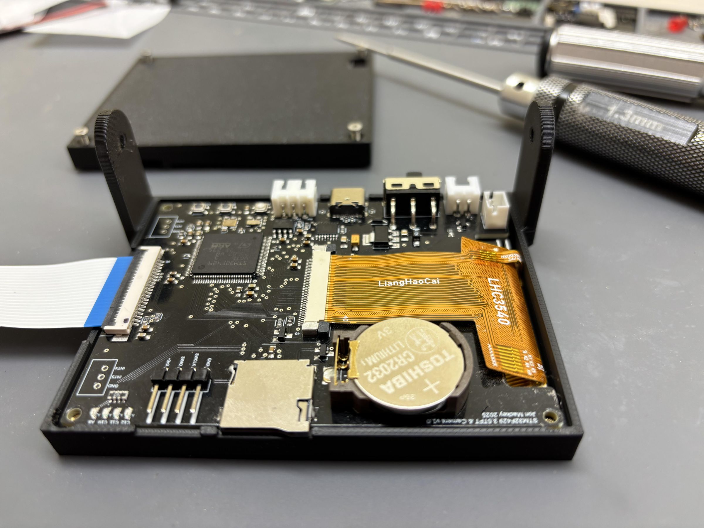

Main Board
The main board uses a STM32F429 mcu to interface with the camera to stream video to a 16 bit parallel 3.5” 480 x 320 display. This board uses the DCMI and FMC features of the STM32F429. Note that this board doesn’t have any SRAM other than the 256KB available in the STM32F429 itself. This means that this board would not be useful for creating high resolution photos. When high res is used the line data is processed immediately and only a small amount of memory is needed.
Soldering the main board
- add the STM32F429 and the 40 pin FFC connector to the board first before any other parts. The pins on these two parts have a 0.5mm pitch making them difficult to mount. It’s easier to accurately check continuity on these two parts before the board is fully populated.
- mount the rest of the surface mount parts.
- cut any through hole pins flush with the display side of the board before soldering to minimize the pin height. The display back is bare metal, so to avoid any shorts when the display is mounted, these pins must be as close to flush as possible.

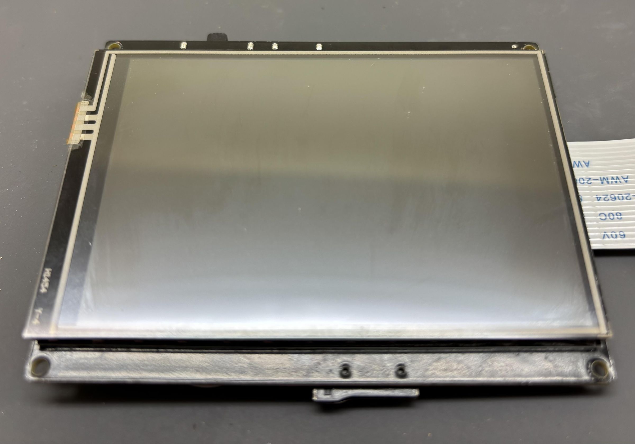

Mounting the display
Display
The 3.5” display should be mounted to the back of the main board using three double layer strips of double sided tape suitable for displays. I recommend using 8mm wide 3M brand 9080 double sided tape. Use six strips total to double the thickness to avoid the bare metal back of the display coming in contact with the pins of the connectors and power switch. My AliExpress source no longer offers this tape. Two years ago I paid under $5 USD including shipping for a 50 meter roll. The best price I could locate today was on eBay
Alignment Accuracy
Alignment Done

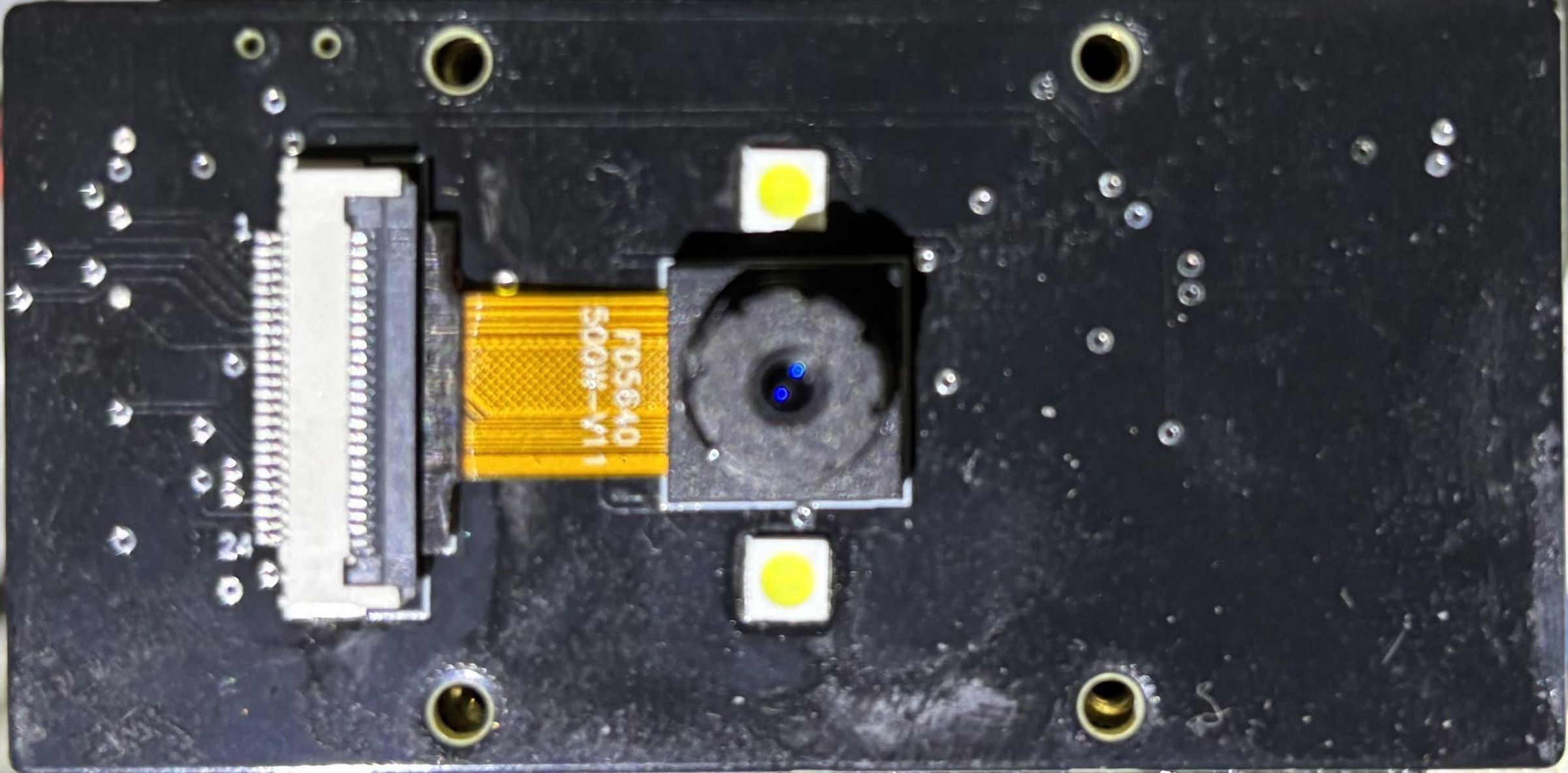

The camera board is an amalgamation of what I could glean from the OV5640 documentation and available camera module schematics. The main reason I designed my own was I wanted to use flat cables (FFC) rather than bulky 2.54 pitch headers and connectors.
The camera board has two 20 pin FFC connectors, one on each end to allow the camera to be oriented in either direction relative to the main board’s 20 pin connector.

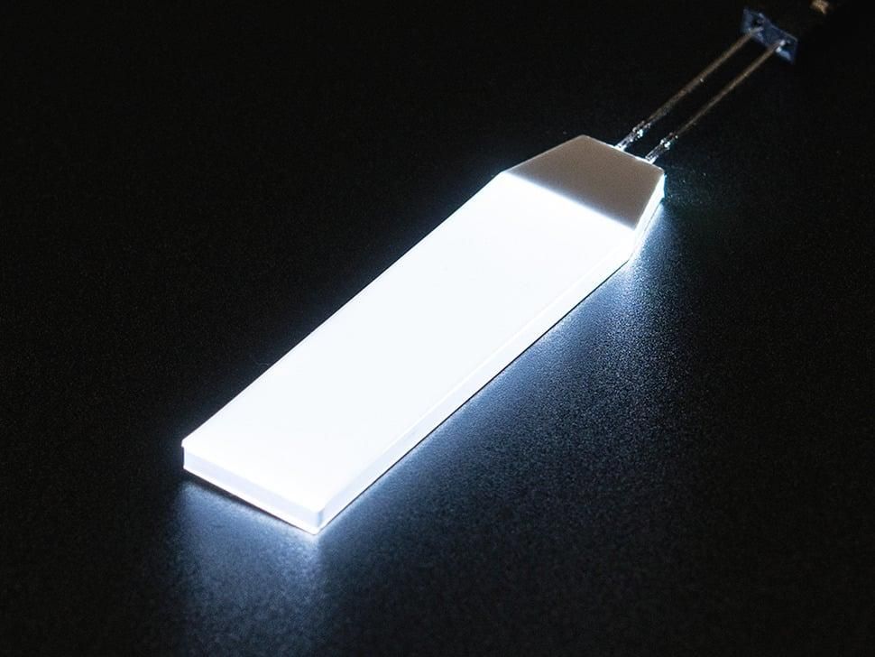

Backlight
Preparing the 12x40mm backlight:
Cut a length of 2 conductor 26 to 22 gauge wire, approximately 18cm long. The backlight requires a current limiting resistor. The resistor specified in the supplies step is a 100ohm 1/4 watt axial lead resistor. From one end, carefully cut just the red wire at 4cm. Remove wire the length of the resistor from the cut red wire. Strip the ends of the cut red wire and apply solder. Snip the resistor leads to size and solder in the resistor. Slide a piece of heat shrink tubing over the resistor, the soldered connection, and the black wire. Apply heat to shrink the tubing.
Using a DVM, determine the positive LED lead of the backlight. Cut both backlight leads to about 8mm and apply solder. From the end of the wire closest to the resistor, strip about 2mm from each conductor and apply solder. Slide a 2cm piece of heat shrink over both conductors. Slide an additional length of heat shrink tubing over just the red conductor. Solder the red conductor to the positive backlight lead and the black conductor to the other lead. Slide forward and apply heat to shrink the tubing on the red conductor. Slide forward and apply heat to shrink the tubing covering both wires as shown in the picture below.
On the other end of the wire, attach a PH2.0-2P connector as shown in the picture below showing the correct polarity.
Backlight AssyPHP2.0 Zoomed
Using a strip of the same tape used to adhere the display to the main board, install the 12x40mm backlight on the Main Board Base print.
Connect one end of the15cm, 20P, FFC cable to the main board as shown below with the blue tab facing up, away from the board.
Main Board
Place the main board into the Main Board Cover print. Place the Main Board Base print over the cover. Use 4 M2x12 flathead screws to secure it to the cover.
Main Board Cover
Main Assy Back

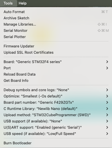

If you don't already have the STM32 boards package loaded, you can load it via Arduino IDE->Tools->Board->Boards Manager... Then load the "STM32 boards groups". I'm using version 2.5.0.
The main board's mcu is a STM32F429VGT6. The software only uses about 10% of the 1MB flash memory.
The 5V power for the main board can be supplied from either the 2 pin XH2.5 connector, or the USB-C connector. The USB-C connector has 5.1K resistors that requests at least 1.5A of power. The board uses much less than 1.5A, generally around 250mA at most when both the camera and display are active.
Apply power and verify that you can measure 3.3V on the main board at the large pad of the AMS1117 voltage regulator and ground. Ground can be found on any bare metal parts, such as the power switch, Micro SD, or USB connector.
Configure the board in the Arduino IDE's Tool menu based on the screenshot above.

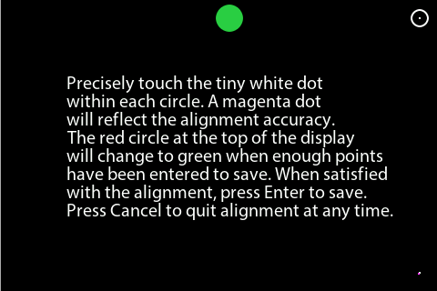

Step 5: Setup

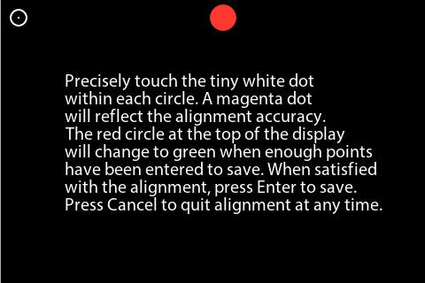

Before the touch panel can be used it must be aligned. There are two buttons on the main board labeled Enter and Cancel. Pressing the Enter button or sending the letter ‘A’ via the serial port, will display the alignment screen as shown below.
Aligning the display
Follow the displayed instructions. Keep selecting the white dot within the circle till the magenta dot covers or nearly covers the white dot.
Alignment Accuracy
Alignment Done
As noted in the instructions in the screenshot above, you keep selecting the white dot within the white circle as they appear in each corner after each click till the accuracy is acceptable. Acceptable is defined as the magenta dots completely or mostly covering the associated white dots. You then press the Enter button on the main board or send the letter ‘S’ via the serial port, to save the alignment parameters to the EEPROM. Pressing Cancel on the main board or sending the letter ‘C’ via the serial port, exits display alignment without saving the settings to EEPROM.
The lens needs to be refocused to an object closer than the focus set at the factory. The OV5640 camera lens has a small dab of hard glue that locks the threads on the camera lens. Using a sharp blade, scratch off the hard glue so that the focus can be changed. Verify that you can turn the lens. Mount the camera board on the “Camera Middle w Open Side” print using two M2x5 screws. Attach the 15cm flat cable with the blue tab facing up. The flat cable should already be attached to the main board. Apply power to the main board and move the power switch to the on position, the position closest to the center of the board. On the main board display, select Color as the Preview type, then press the Preview button. With a key inserted in the key slot under the camera, an out of focus key should appear. Adjust the lens on the camera till an in focus, sharp image appears.
Mount the camera board on the “Camera Middle” print using two M2x5 button head screws. Mount the camera board cover using two M2x12 flathead screws.

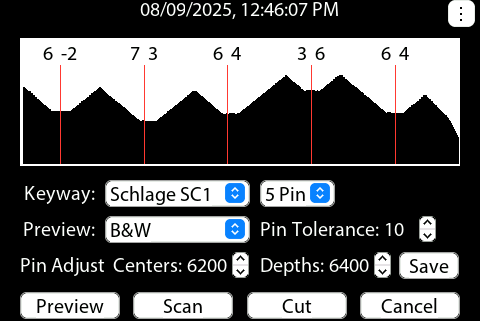

With the preview mode set to B&W, press the Preview button. A preview image should appear on the main window. Adjust the key verifying that it is in the key slot firmly against the stop and straight. You can tell it’s straight when you don’t see a jagged edge on the bottom flat edge of the key blade.
Press the Scan button. After a few seconds a magnified image of the key cuts should appear. Note that the few second delay is due to the fact that the first 3 high res frames are always skipped because they are unusable. Once the camera stabilizes, around the 4th frame, the data is checked for errors. In some cases a few more frames are skipped.
Scan SC wo adjustments
Once a magnified image of the key cuts appears, there should be a vertical red line in the center of each cut. The left most red line should always be in the center of the first cut, and the remainder of the red lines may be a bit off center.

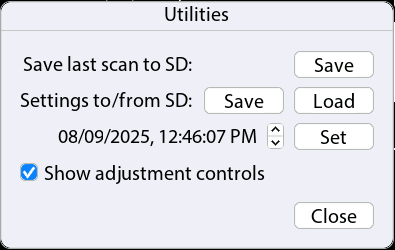

Utilities Dialog
From the main menu, open the Utilities dialog. Select ‘Show adjustment controls’, then close the dialog. In the main window you should now see additional controls to set the pin tolerance, centers and depths. The pin tolerance is the allowable deviation from the key specification for any pin in pixels. The scale from pixels to unit of measurement is controlled by the centers and depths values. The centers value is the horizontal scale along the key blade, and the depths value is the vertical scale across the blade. I expected these scales to be the same but they’re slightly different, and most likely different for each camera based on focus. Note that a scale value of 6200 is 0.00062 of an inch per pixel. Therefore 6200 and 6300 are quite close. The allowed range for scale values is 6000 to 7000.
Scan SC w adjustments
The first adjustment to be made is to the centers scale. Changing the value of the Centers scale will move all of the center lines to the right of the first cut. The Centers value can be changed from the main window using the up and down stepper control or by sending a new value via the serial port. Using the serial port is the fastest way of changing a value. The serial format is the letter c followed by 4 digits and a newline. For example, ‘c 6300’ will change the centers value in the main window to 6300 and will redraw the red center lines to reflect the new centers scale. Make changes to the centers value till the red center lines are, on average, in the center of each cut.
Now adjust the depths scale. Like the centers scale, the depths scale can be changed using the stepper control or via the serial port. The serial format is the letter d followed by 4 digits and a newline character. For example, ‘d 6375’ will change the depths value in the main window to 6375 and will redraw the cut pin indexes above each red center line to reflect the new depths scale. When the adjustment controls are showing, the cut pin index above each red center line will also include its deviation from the specification. Play with the depths value till the average deviation is low, something within the tolerance. When it’s outside of the tolerance the letter ‘C’ will replace the expected cut pin index which means it’s custom. In most cases you don’t want a custom cut. For most house locks, the key cuts should be standard indexes. When you’re out of tolerance it generally means that the depths scale is off.
Once you get scale values that appear to be accurate, try scanning other keys to verify the accuracy.
If the accuracy looks good, press the Save button to save your changes to EEPROM.
Go back to the utilities dialog and uncheck the ‘Show adjustment controls’ checkbox to hide the adjustment controls in the main window.

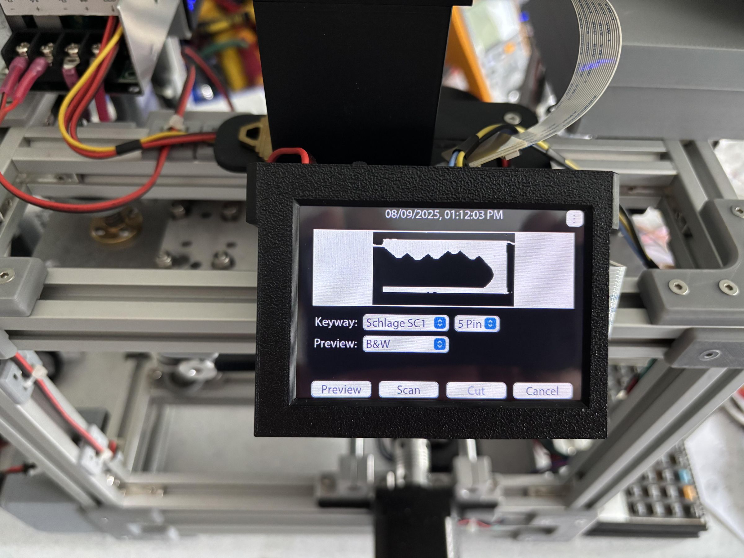

Step 6: Normal Operation
To cut a key
- mount a key blank in the key machine's key holder.
- insert a key in the key slot under the camera.
- preview the key by pressing Preview.
- verify that the key is up against the stop and is straight.
- scan the key by pressing Scan.
- once the scan finishes press the Cut button.
That’s it. The cut information will be sent to the key machine control board and cutting will begin.
