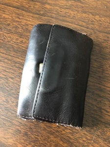

This is the key wallet I have been using for quite a few years. The leather exterior is still intact and feels good in my pocket. The inside portions of this key wallet are no longer as good. A couple of months ago one of my house keys fell out and I lost it. Before that, my key wallet occasionally separated from my car key while I was driving and the wallet fell to the floor of my car.

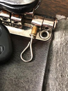

I attach my keys with a closed wire ring I added. I am able to do that because I have a wire feed welder. If I could find a smaller key ring I might use one of those and spare myself the effort.

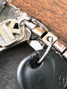

Please click on the photo with this step and look at the text boxes I added. One highlights the factory-made hole for the removable hook. Another indicates a hole I drilled in the side of the hinged mount for the removable hooks. The wire loops I made need a second hole so they can pass through the hinged mounts.
One of the text boxes highlights a flawed weld that is barely acceptable. Another text box shows mars in the plastic on my car key where heat from the weld permeated the wire loop and melted the plastic. I should have had a wet rag nearby before beginning to weld.
I tried to keep the wire loops as small as possible. It helps that I am retired and carry fewer keys than I once carried in this key wallet.

I already mentioned the problem I had because a heated section of wire came into contact with the plastic on my car key. And, I mentioned a barely acceptable weld. Commercial key rings about 5/8 inch in diameter would be a good choice. If they exist, I may not have looked hard enough.

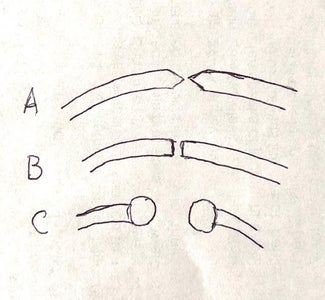

The wire I used is about 15 gauge steel wire from the hardware store. I bend the loop I need. The key must be on the loop and the loop must pass through the holes in the hinged mount. I let some of the key wallet hang off of a piece of aluminum angle I use while welding. The aluminum angle functions as a heat sink to help keep from blowing away the wire with too much heat. I use spring clamps to hold the wire in place on the aluminum background piece. Sometimes the welding wire coming out of my welder's gun has a curve in it and the weld does not begin exactly where I wanted it.
See "A" in the drawing above. If I use a side cutter to cut the wire, the ends have points. I need to get them as close as possible or I get what you see in "C." A gap forms between the ends of the wire with balls on them from wire that melted and ran away. If I square the ends as in "B" I am less likely to get the result seen in "C." Still, it is a contest with yourself to fuse the ends of the wire together without the ends melting and running away. Sometimes I need to cut a new piece of wire and try again. It does not help that the wire from the hardware store usually has some kind of coating that does not weld very well.
