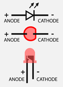

A normal LED requires ~20mA wich is 0.02A at 2-3volts. We found previously that the voltage between + and GND was 3V, thanks to Ohm's law we have : U = R*I (with U voltage, R resistance, I current).
We already know the voltage and the current we want, so we need to find the right resistance. So, we have R = U/I => R = 3/0.02 => R = 150 Ohm. Because I only have 100 Ohm resistances I chose to go with it.
If you want to be precise, the LED will receive I = U/R => I = 3/100 => I = 0.03A or 30mA. Wich I decided to be acceptable.
If you look at the last image, you find that the ANODE is the longest pin of the LED, wich will conect to + (the switch) and the other to the GND. You'll put the resistance in serie between the LED and the switch or GND and the switch. Make sure to put electrical tape or shrinking tubes to hide any conductive part.
Finally, solder to the board and it should work fine !
