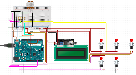

Step 1: The Circuit
Build the circuit like the picture above.
Note:
  • The rightmost components are the buttons.
  • The green component is the LCD Screen.
  • The wire connected to D2 can also be connected to SDA.
  • The wire connected to D3 can also be connected to SCL.
  • The 5 resistors for the buttons should be 10kΩ resistors.

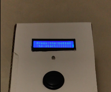

Stick the buttons, LCD screen, and the rotary potentiometer onto the cardboard according to the picture above. The top button is connected to D4. The left button is connected to D6. The middle button is connected to D8. The right button is connected to D7. The bottom button is connected to D5.
Step 3: Building - 2
Attached the cardboard to the top of a box. Leave a side open so it will be easier to change the component inside if there is a problem.
