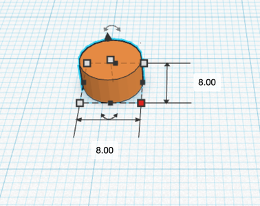

Step 6: Creating the Keychain Hole
Grab 2 cylinders (one regular and one hole cylinder) from the shapes panel and set the dimensions of your cylinders.

Step 9: Piecing Everything Together
Using all the objects you have made, put all your objects together and make sure you have the right dimensions.

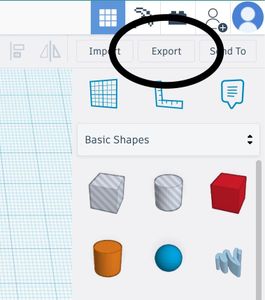

Step 10: Exporting
When you are done, right above the shapes panel there should be an "Export" button. Click on it and click on ".stl" so you would be able to use your design on a 3D printer.
