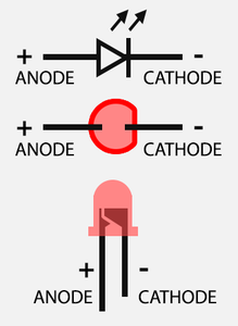

I hope you have met and known the basic of this famous semiconductor called LED. If you don't, please visit this instructables All You Need to Know About LEDs. There are basic information about the circuit and type of LEDs.
In short, I will tell you that LED has polarity. The larger piece inside the LED (shorter leg) is cathode, we put it at the bottom of the battery. The smaller piece inside (longer leg) is anode and connect it to the top side of battery. If you put it the wrong way, it will not illuminate.
Bend the end of the cathode leg with pliers into a circle shape with the overlapping part goes on top of the previous leg to get a better connection to the battery negative terminal (bottom).
